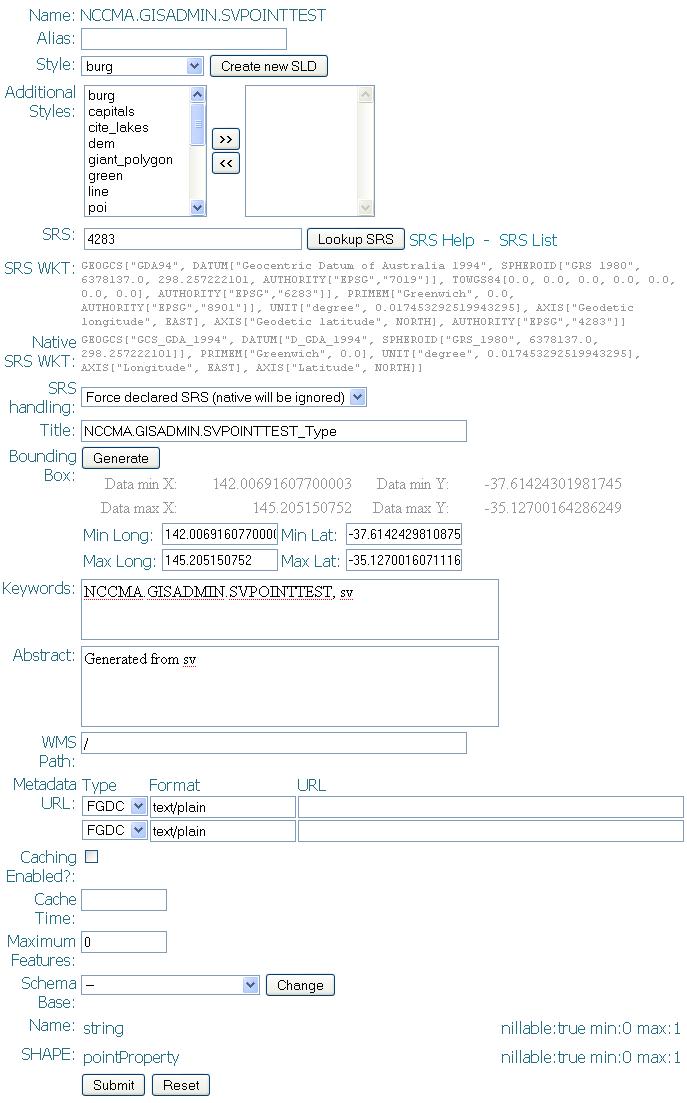

I am using the exact setup that you are using, however I am still having trouble getting all Update, Insert & Delete to work together. I can either get Update and Delete to work, or just Insert, but not all three at the same time. I have posted the error trace of the problem in another reply under the same subject: Re: [Geoserver-users] Geoserver ArcSDE WFS-T.
Would you be able to give me an example of how you set up your namespace, datastore, and featureType in GeoServer?
This is my setting:
Namespace:
Datastore:
  • Name: sv
  • Enabled: checked
  • Namespace: sv
  • Server: server_name
  • Port: port_no
  • Instance:
  • user: user_name
  • password: password
  • pool.minConnections: 2
  • pool.maxConnections: 6
  • pool.timeOut: 500
FeatureType:
  • see attached jpg.
Thanks for your help.
