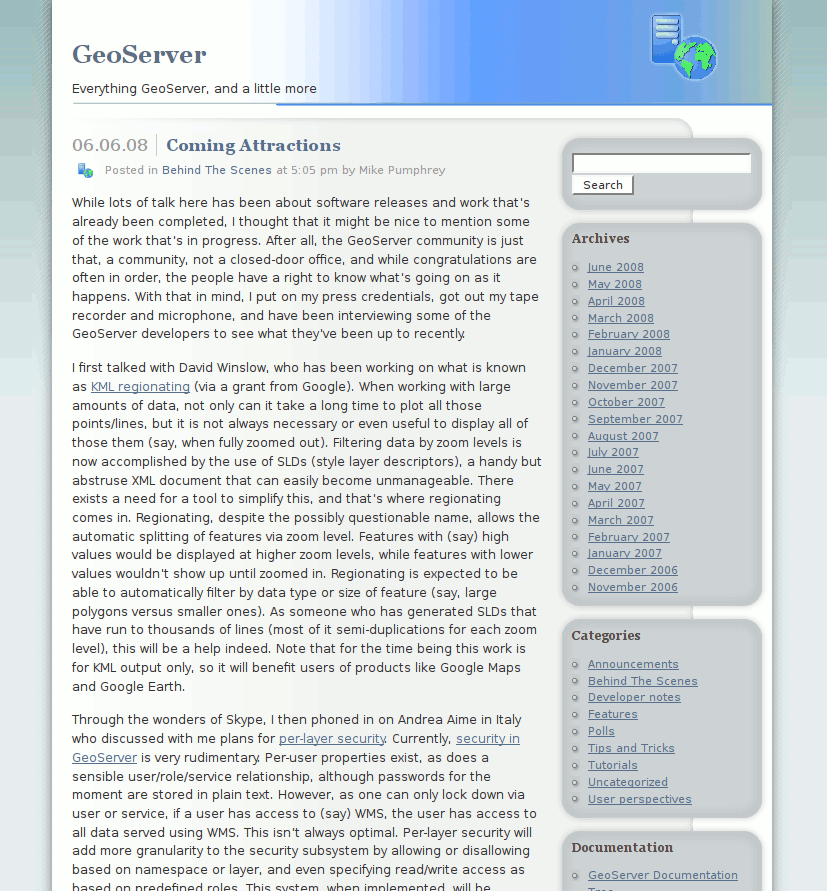

Hi Sean,
Yes, blog.geoserver.org is legitimate. However, your email makes me
think you're not looking at the same page that I am, so I have attached
a screenshot of what the page currently looks like.

Arne,
blog.geoserver.org does resolve to that address for me. The SPAM is not visible on the web page itself but is visible in the source (e.g. http://dpaste.com/55263/) and I do see it in the RSS feed.
It's only in the last two posts "GeoServer 1.6.4 Released" and "Coming Attractions".
Does no one else see it?
Sean

My bad, you were absolutely right. We received another email giving us
more details.
There was spam all over the page and in the RSS feed. The reason I
didn't see it was that it was enclosed with CSS and XML markup that made
it invisible in most browsers, including Firefox 3 and Opera, which I
currently use.
Thank you for reporting this, we've reverted to the default template
until we can say with confidence the loophole is not present in our
customized template.
-Arne
