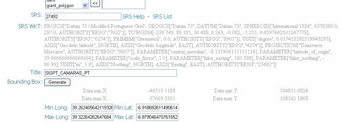

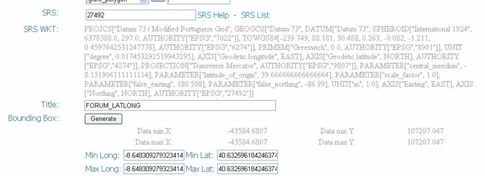

Here's an example:
1º SRS=27492 (bounding box not encloses my dataset)
2º SRS=4326 (bounding box encloses my dataset)
Thanks,
Diogo

My dataset is in Oracle spatial with SRID = 27492.
Here’s an example of my geoserver configuration:
This configuration generates an image blank. What is wrong? I need define another SRS?
Thanks,
Diogo

The EPSG code 27492 is declared as a projected system. Even from the screenshot you've sent me, you can see that it's declared as a projected
system on top of a geographic one, which is obviously defined as lat/lon (well, it may be lon/lat, but that's a different issue).
If you look at the end of the wkt, you can see that the axis of the
projected system are Northing/Easting.
I really never seen in the wild something using X/Y (besides pure cartesian data coming from CAD systems), is this something Oracle specific?
So, when I load my dataset in geoserver and I make Geoserver compute the lat/long bouding box, the values of bounding box in lat/long it's could be correct in Lat/Long, but because my dataset it's in X/Y, the min and max values not encloses my dataset and I can't see nothing.
First thing, I'd check it's axis order. Are you using Geoserver 1.5.x beta? If so, make sure your web container is started with the:

My dataset is one point with coordinates X= -43584.6807 Y= 107207.047 in SRS
= 27492, stored in oracle spatial.
When I load my data in geoserver I get this:
For view my data, I send the request:
http://localhost:8888/geoserver/wms?bbox=-43585,107207,-43583,107208&request
=GetMap&layers=topp:FORUM_LATLONG&width=800&height=400&srs=EPSG:27492&styles
=point&Format=image/png
,and I get one image blank.
Note: in attached I send logs of geoserver.
Diogo
