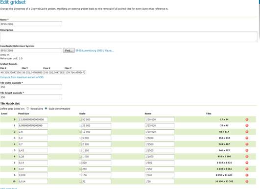

Hi,
1.in Tile Caching of GeoServer I create firstly a new gridset for EPSG 2169 for Luxemburg with the Zomme Lavels 1-10 the Gridset bounds are Compute from maximum extent of CRS.
Inline-Bild 1

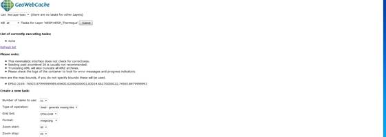

2.I configure the Caching Defaults with the Gridset of ESPG 2169
Inline-Bild 2

Hi,
I try to add a WMTS Layer from my GeoServer but the issue still that the axis orientation wrong. I m using the EPSG 2169 for Luxemburg and generate the tiles with this Gridset
Inline-Bild 1
Have you any idea what is the issue?

Tarek Benamara wrote:
Hi,
Inline-Bild 1
Inline-Bild 2
Hi,
Inline-Bild 1
