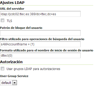

Hi Luis, I think you hit a bug in the LDAP admin interface.
The problem should be only related to the test connection functionality, you can try to save the configuration and use it in the authentication chains. It should work from there.
I will open a ticket to fix the test button.

and the config that i used
Imágenes integradas 1
Thanks again Mauro

Ok, I have looked at the code and I see that sAMAccountName={1} is accepted
as a filter only on master, and not supported on 2.4.2, I will see if I can
backport the fix to 2.4.x shortly and let you know. Would you mind using a
nightly (or I can send you directly the fixed jar to test)?
