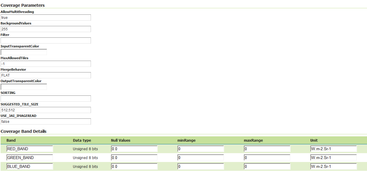

Hi Simone,
That’s “good” to hear (in a certain context :slight_smile: ).
To answer your questions:
  • GeoServer 2.5.1
  • WMS resource limits are the defaults. So:
    Memory: 64000
Time: 60
Errors: 1000
  • ImageMosaic parameters in screenshot:
    Inline images 1
  • Structure of the underlying data. What do you mean? It’s 13 irregularly sized/shaped GeoTIFF images created by GDAL in the standard way. They each contain tiles and overviews. The data is RGB Aerial photography compressed with JPEG YCBR.
Hope that’s enough information to be going on. I can provide more if desired.
    Inline images 1

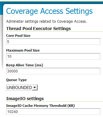

can you paste the gdalinfo on one of these files?
Moreover can you share also the JAI and Coverage settings?
That said, I would suggest replicate and take at least a jstack dump. The others quick dumps listed here would be of help:
http://docs.geoserver.org/latest/en/user/production/troubleshooting.html
I’d like to see what threads are being blocked onto if we are not respecting the 60s limit

Hi Simone,
Responses inline
It got to 20 mins before I killed it by restarting GeoServer. Standard “net stop geoserver_instance” didn’t work. Had to be forceful.
I can do better:
http:\maps.warwickshire.gov.uk\shr\AP_2012_2013_imageMosaic.zip - that file has two of the tif files in it. It’s about 100MB.
Inline images 1
Inline images 2
I’ll try and get onto that on Monday.
This is a Windows 2008 R2 server.
Cheers,
Jonathan
and the runaway request lasts for more than 60s?
This transmission is intended for the named addressee(s) only and may contain confidential, sensitive or personal information and should be handled accordingly. Unless you are the named addressee (or authorised to receive it for the addressee) you may not copy or use it, or disclose it to anyone else. If you have received this transmission in error please notify the sender immediately. All email traffic sent to or from us, including without limitation all GCSX traffic, may be subject to recording and/or monitoring in accordance with relevant legislation.

- Structure of the underlying data. What do you mean? It's 13 irregularly
with JPEG YCBR.
Hope that's enough information to be going on. I can provide more if
desired.
    Inline images 1
    Inline images 1
    Inline images 1
    Inline images 1
