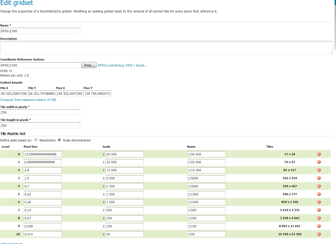

Hello Tarek,
You have set wrong Min / Max Values - or to be more precise you have set the Max X Value into the field for MinY!
So you have set the values like: MinX - MaxX / MinY - MaxY
But the dialog wants:
MinX - MinY / MaxX - MaxY

Hi,
I try to add a WMTS Layer from my GeoServer but the issue still that the axis orientation wrong. I m using the EPSG 2169 for Luxemburg and generate the tiles with this Gridset
Inline-Bild 1
Have you any idea what is the issue?
