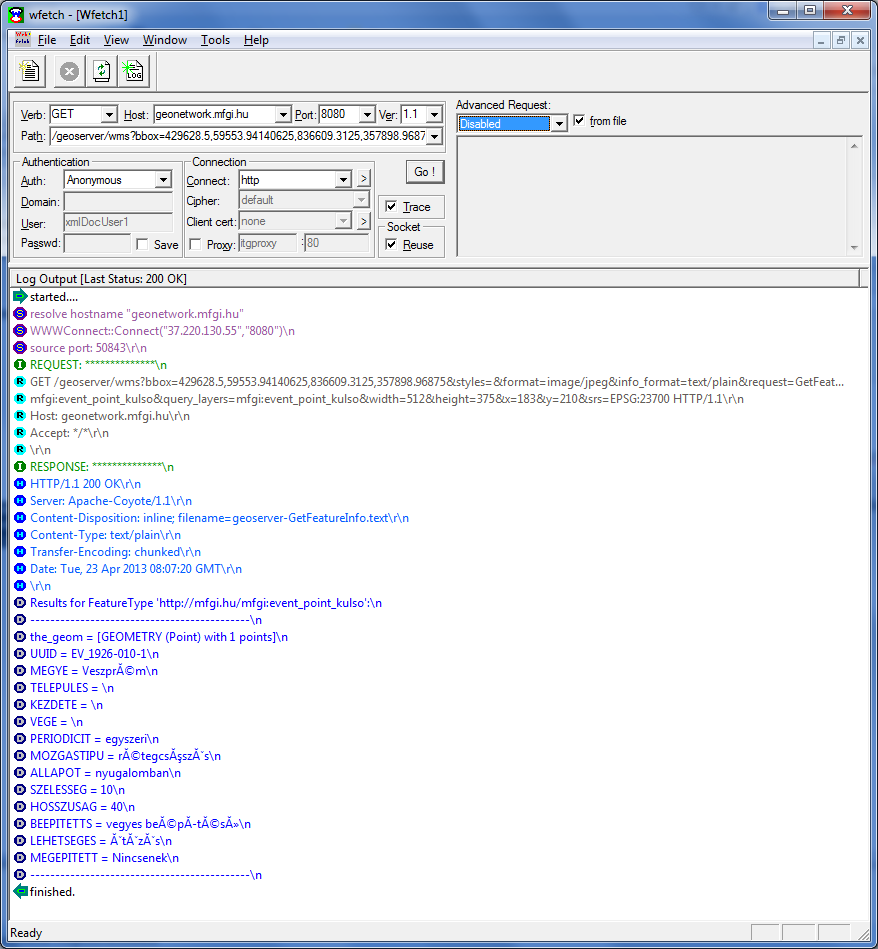

I am migrating data from Geoserver 1.7.2 to 2.3.0. When I connect a specific WMS layer from Geoserver 1.7.2 to Geonetwork, the map viewer renders getFeatureInfo response properly. When I connect the same layer from Geoserver 2.3.0 Geonetwork map viewer fails to show UTF-8 characters.
The reason is probably the HTTP Content-Type in the response header.
Geoserver 1.7.2:
Content-Type: text/plain;charset=UTF-8
Geoserver 2.3.0:
Having no charset attribute the client misinterprets encoding.
Is there any way to let the client know that the response from Geoserver 2.3.0 is a UTF-8 text?

Hi Andrea,
Thanks for the response!
In both cases I use Tomcat. I have checked the response with wfetch, and Geoserver 1.7.2 behavior is different from Geoserver 2.3.0. The problem only occurres when GetFeatureInfo format is text/plain, otherwise charset is defined in the html or xml header. Unfortunately, Geonetwork seem to use text/plain. However, the root of the problem is the ambiguous output of Geoserver.
If there is no way to make Geonetwork assume that the undefined charset is UTF-8, is there any workaround for the problem in Geoserver or tomcat?
Best regards,
Laszlo
Geoserver.
Not that I know of. As said before, I have a hard time considering this a
bug too, I don't remember OGC demanding the charset to be added to the
mime types.
