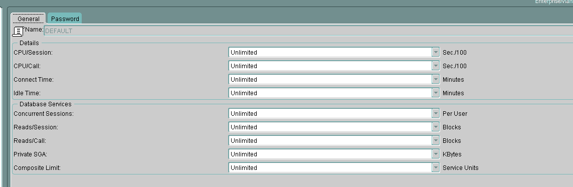

Hi Andrea,
I sent your note off to my DBA to see if we’re imposing a connection timeout on the geoserver user. He replied in the negative; the geoserver user is under our default profile, and there is no timeout imposed under that profile. He sent the a screenshot of the profile to confirm. Is there anything else it could be?
Aaron

Hi Andrea,
I sent your note off to my DBA to see if we're imposing a connection timeout
