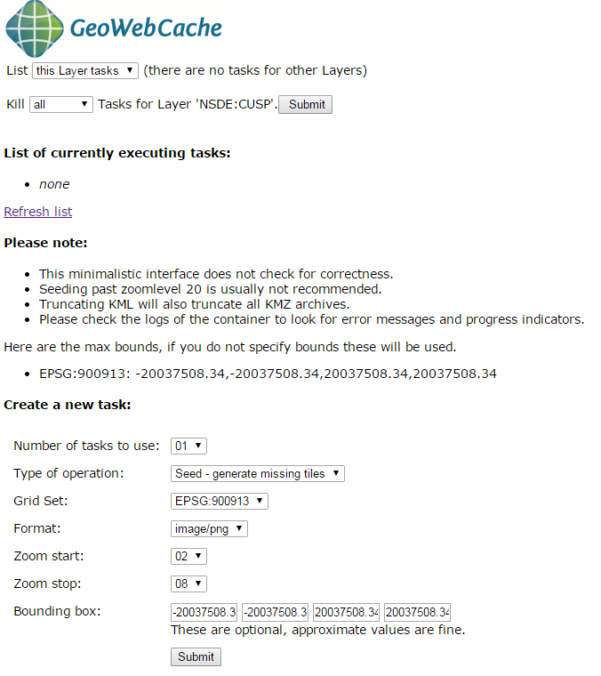

Hi, GeoServer users,
We ary trying to use GeoWebCache Seed/Truncate GUI to reseed/seed/truncate our current layers.
We encountered following issue:
While we input values for bounding box and click the submit, the return web pages only shows a number of “14”. There are nothing else displayed. We used EPSG:900913 as Grid set with image/png as format and bounding box value is under EPSG:900913.
Anyone has ever encountered the same issue or have any idea?

Hi Aijun,
I’m guessing you’re trying to use the integrated GWC seeder tool? If so you shouldn’t be getting that response. Its been a while, but I’m fairly sure that if what you’ve entered is valid, it should instantly start acting on it.
Alternately, if the web-interface is failing you, you could try using the API: http://docs.geoserver.org/stable/en/user/geowebcache/rest/seed.html

Hi, Jonathan,
Thanks for your kind explaination.
Yes. I am using integrated GWC seeding/truncting tool.
Right now, the tool works fine if I don’t provide coordinates of bounding box for specific area.
However, when I provided a non-default bounding box, the response webpage only shows a number of “13” or “14”.

Hi Aijun,
Verify that the coordinates entered are valid for the coordinate reference system desired. I seem to remember having issues in the past entering WGS84 (EPSG:4326) coordinates by mistake when I needed to enter web Mercator (EPSG:3857) coordinates, or the other way around.

Hi, Shamus,
Yes. You are right. I did realize this issue.
And I used EPSG:900913 and entered the coordinates that are showed for EPSG:900913 in default by GWC.
I also tried different coordindates under EPSG:900913.
It still returned “14”
See attached screen-cutting.

Hi, Shamus,
Thanks a lot.
I will follow your suggestion to have a try when I get time.
Aijun,
On Mon, Jan 12, 2015 at 3:50 PM, Fuller, Shamus <sfuller@anonymised.com> wrote:
Hi Aijun,
I had seen that error a long time ago, maybe a year or two ago, but I do not have in my notes any reference to it, so I do not know what caused it or how it was fixed, sorry.
I would guess you have already tried but the only other suggestion I have is to restart the server, try a smaller extent, try a different CRS and see if you get a different result. You may be able to turn on a more verbose log level and get something useful in the logs.
