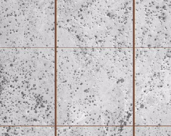

I am creating an ImageMoasic from GeoTiff images created with gdal commands:
gdal_translate -co COMPRESS=JPEG -co PHOTOMETRIC=YCBCR -co TILED=YES -co JPEG_QUALITY=85 $infile $outfile
gdaladdo --config COMPRESS_OVERVIEW JPEG --config PHOTOMETRIC_OVERVIEW YCBCR --config INTERLEAVE_OVERVIEW PIXEL -r average $outfile 2 4 8 16 32 64 128
When viewing tiled mode in the OpenLayers preview at full resolution (about 1 meter) or near full resolution, I get these grid lines. This doesn’t happen when using single tile mode.
I found this post with a similar issue, but the solutions won’t work for me.
http://gis.stackexchange.com/questions/82746/white-lines-in-merged-geotiff-files-after-imagemosaicing-on-geoserver
Inline image 1

Do you face the problem at all zoom levels?

Can you please try to add less overviews?
I guess 2 4 8 16 32 is sufficient in your case (well it depends on the dimensions of your granules). Maybe you can send a gdalinfo of a geotiff in order to take a look.
On Wed, Apr 20, 2016 at 7:53 PM, Jason Newmoyer <jason@anonymised.com> wrote:
No only at near full resolution. So for this data that’s around 1:2,000. I see the lines anywhere from about 1:8,000 all the way down to 1:1.

Alessio,
Does having the extra overviews cause an issue? I assumed its better to have more than you need rather than less. Since at a factor of 64 or beyond they really cost almost nothing in terms of processing or space.
Here is the gdalinfo for one of my tiles.

So, looking at the GDAL_INFO output I suggest to retile internally the granules as square tiles (e.g.: 512x512).
You can use gdal_transale -co “TILED=YES” -co “BLOCKXSIZE=512” -co “BLOCKYSIZE=512” in order to do that. This will improve a lot the performances.
Moreover, generally speaking, it is not advisable to have overviews with size lower than the internal tiling. You will force the server to do unuseful extra-work other than risk to introduce artifacts.
Therefore in this case overviews of size 512x512 are sufficient (2 4 8 16 32).
Try if it works like this.
Also, if you do the preview using an OpenLayers-like client in tiling mode, you must be sure that the browser page zoom level is 100% otherwise it may introduce unwanted lines in the middle at client side.
I hope it will work just following those steps, otherwise the issue may be more serious.
granules as square tiles (e.g.: >512x512).
Somehow I did not send the proper Gdalinfo output. I am using the
gdal-default internal tile size of 256x256.
I am now unable to reproduce this issue, and not sure what changed. I will
keep an eye out for it.
than the internal tiling. You will >force the server to do unuseful
Good tip, I did not know that.
unwanted lines in the >middle at client side
Also experimented with this to try and reproduce, but no luck.
Thanks!
