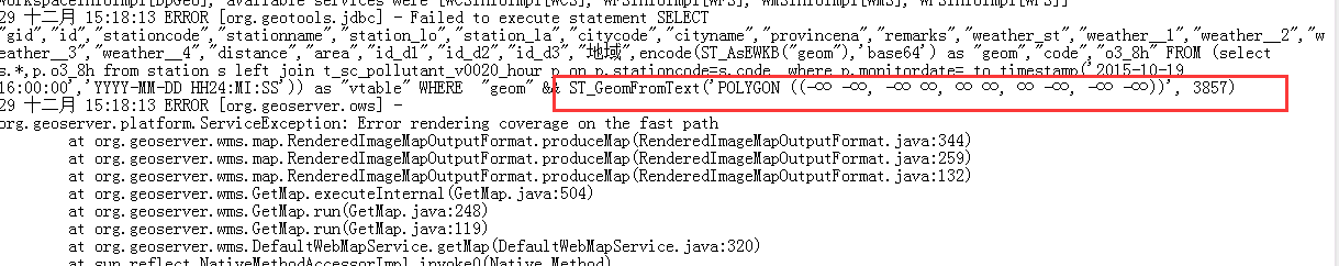

Hi:
GeoServer logs info:
2015-12-24 23:25:36,863 ERROR [geoserver.ows] -
org.geoserver.platform.ServiceException: Error rendering coverage on the fast path

Hi :
I found below info in log, Why not get the layer’s bbox?

Hi,
so you have your data stored in 3857, which is a projection meant mostly for visualization, instead
of data storage?
What does your GetMap request look like?
I’m asking because if you are asking for a whole world in EPSG:4326, like BBOX=-180,-90,180,90 (or -90,-180,90,180 if
you are using WMS 1.3), then GeoServer will try to reproject that back to EPSG:3857 in order to query the
database, and that project cannot handle poles, so you will get some infinites in the result.
We have logic to cut the area to a valid range for 3857, but I’m not sure it’s working when rendering
transformations are in the mix (it’s a case we haven’t tested yet).
I’m also wondering, does it break also if you just apply the barnes surface, without also extracting the contours?
Chaning rendering transformation is another case that is known not to work very well (while theoretically
it should, we only ever got funding to work on single rendering transformations, so it’s another
case that’s not well tested).
Cheers
Andrea

Hi :

On Sun, Dec 27, 2015 at 12:03 PM, 冷月残风 <871703246@…886…> wrote:
Caused by: org.postgresql.util.PSQLException: ERROR: parse error - invalid geometry
建议:"POLYGON ((- " ← parse error at position 12 within geometry
It seems there is an unexpected character there. Never seen this particular error, I’m wondering if it
may be due to your local language, in particular, in a mismatch between GeoServer, using chinese
encoding, and Postgresql, maybe using English one (the C convention), or vice versa.
You might want to check how both ends are configured, in particular, in which language the
database has been created.
It could well be something else, as said, I’m not familiar with that particular error.
Cheers
Andrea
