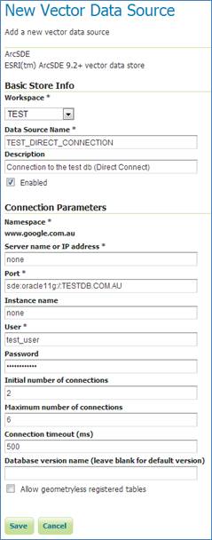

But a direct connect using the following details does not work:
Server name or IP address * = none, Port * = sde:oracle11g:/:TESTDB.COM.AU, Instance name = none, User * = test_user, Password = testPassw0rd
The error message I get is:
Error creating data store, check the parameters. Error message: Can’t create connection to none for Session #22[SDE error -66][Error desc=SPECIFIED PARAMETER VALUE IS INVALID.][Extended desc= ]
I have tried putting TESTDB.COM.AU in the Server name or IP Address entry, i have tried putting sde in the instance name, I have tried a heap of variations of the password such as testPassw0rd@anonymised.com., test_user/testPassw0rd@anonymised.com , test_user:testPassw0rd@anonymised.com … but I still get the same result.

So it seems to actually connect despite the GeoServer interface failing (a bug I’ll report in a minute).
My connection details:
Inline images 1
Despite what the documentation says. My password is only of the form “password”, not “password@anonymised.com”.
It also “works” without the extra “:/” in the “port” string.
Hope that helps,
Jonathan

So, after more extensive testing, the only thing I can say is, I’m confused. I don’t think that wall of connections was actually from the direct connect but was an issue from the regular ArcSDE connection I’d created.
Error creating data store, check the parameters. Error message: Can’t create connection to sde:oracle11g:co_gislive for Session #20[SDE error -66][Error desc=SPECIFIED PARAMETER VALUE IS INVALID.][Extended desc= ]
Jonathan
Inline images 1
Hope that helps,
Jonathan
So far I’ve had the following happen:
a) When I have what I think are the right credentials (as in original screenshot), I don’t get any error or feedback at all when I press save.
b) But if I make it “wrong” information (add a typo), then I get an error that appears to be the same as yours Peter:
Either way, it completely fails to actually connect as best I can tell. But the two different failure modes suggests that maybe your credentials are wrong.
Best I can manage I’m afraid. I’ve never gotten on with ArcSDE. :slight_smile:
Regards,
Jonathan

Hi Jonathon,
I have been able to replicate the same problem you are having with the schema name type connection under http://webhelp.esri.com/arcgisserver/9.3/java/index.htm#geodatabases/arcsde-2034353163.htm.
The schema name for me is sde as sde is the schema that owns the geodatabase. So my connection string to testbd.com.au, in the port section, would be sde:oracle11g:sde or sde:oracle11g:/:sde (as using sde:oracle11g: testbd.com.au or sde:oracle11g:/:testbd.com.au doesn’t work). I get the same issue as you where it seems do nothing at all and returns no error.
I guess I am confused as to how Geoserver knows which database to connect to if I use the schema name. I have a database called devbd.com.au in my TNS names file that has the exact same structure as testbd.com.au and has the same schema name of sde. The only difference is the passwords.
So for testbd.com.au I have:
schema name: sde
User Name: test_user
Password: testPassw0rd
connection string under port: :oracle11g:sde or sde:oracle11g:/:sde
and for devbd.com.au I have:
schema name: sde
Password: devPassw0rd
How does Geoserver know which database I am trying to connect too if I don’t use a connection string like sde:oracle11g: testbd.com.au or sde:oracle11g: devbd.com.au?
I guess I should log the original email as a separate bug but I have no idea if I am entering my details in correctly or not.
Cheers
Pete
Error! Filename not specified.
Despite what the documentation says. My password is only of the form “password”, not “password@anonymised.com8…”.
Hope that helps,
Jonathan
Hope that helps,
Jonathan
