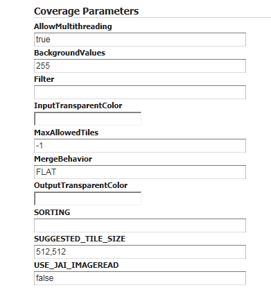

Hi Andrea,
I downgraded the server to 2.4.3 - the issue went away - nice and fast responses.
I’ve now upgraded to 2.4.6 and the issue came back - the layers are slow again.
So something between those versions induces a significant slowdown.
To try and answer your questions:
  • The mosaics are just standard affairs. Irregularly shaped tif files (inner pyramids and tiles) that GeoServer automatically processed.
  • The index is stored in a shapefile (created by GeoServer) stored with the imageMosaic data.
  • I’m not sure about imageio reads - where’s the config for them? I can’t see anything in the store.
Inline images 1
Hopefully that narrows what can have caused it.
