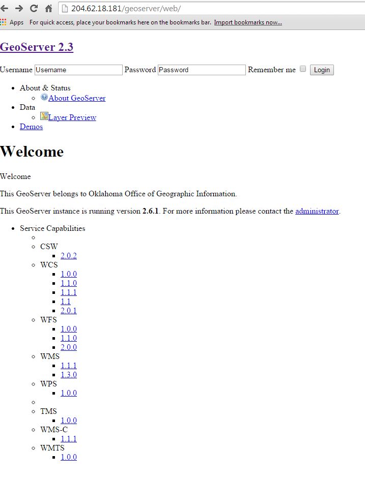

Good morning,
I just installed 2.6.1 after upgrading the JRE to the latest JRE 1.7 (64 bit) as required. Most everything seems to work in GeoServer, but the UI is text only in both Chrome and FF on Win7, see the screen shot.
Am I missing something?
Thanks,
Roger
On 21-11-14 10:44, Roger Bedell wrote:
Good morning,

I tried ctrl f5, and cleared the cache as well, with no success - tried IE, FF and Chrome. Perhaps you can see from here:
http://204.62.18.181/geoserver/web/
Thanks,
Roger

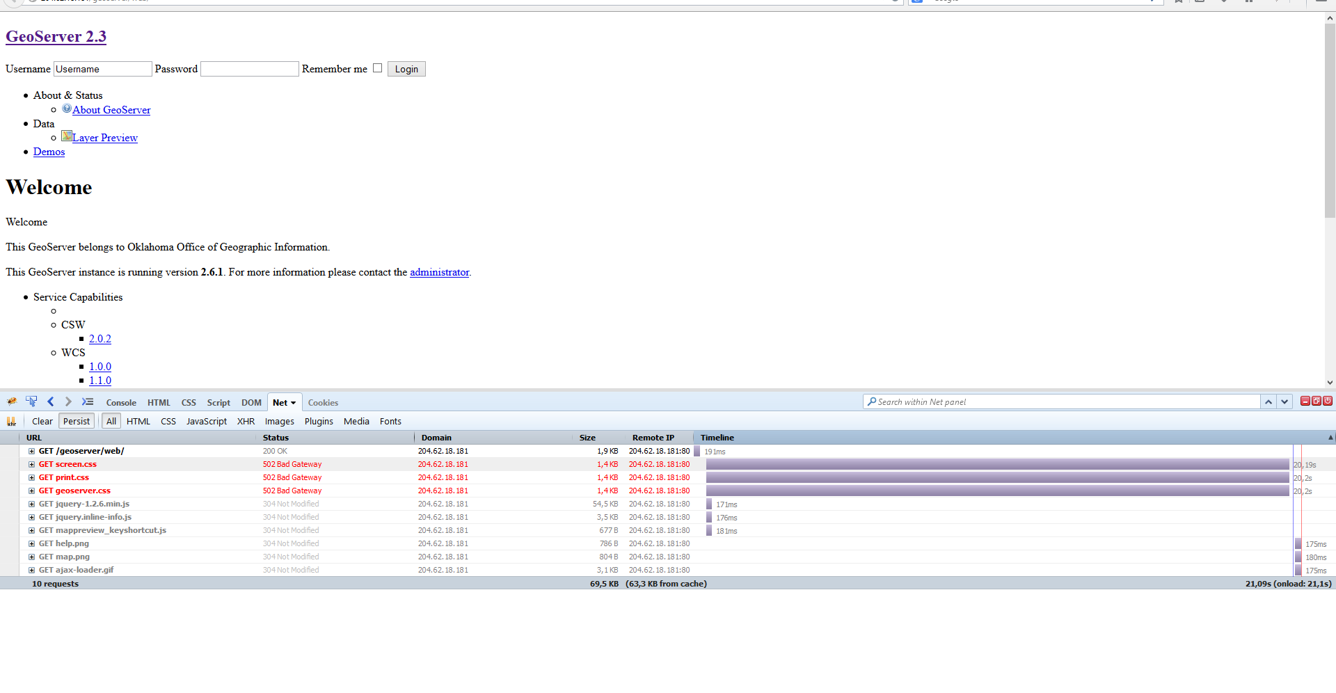

On firebug your site says "Bad gateway" on tree lines:
screen.css
print.css
geoserver.css
See file attached.
AJL

On Fri, Nov 21, 2014 at 12:33 PM, Roger Bedell <sylvanascent@anonymised.com>
wrote:
Well, yes this is true. But shouldn't GeoServer provide these resources?
GeoServer is declaring a wrong (larger) content length for the gzip
compressed files returned by the GUI (css is one of them)
and the browser just keeps on waiting for the data to come.
We are fixing this, but the issue is relatively common, and browsers are
also fixing the issue. It seems it's due to a CSS parser
change that occurred in Chrome, and Firefox inherited it because it uses
the same
If you cannot update/change browsers, you can go in web.xml and comment out
compression for the css and javascript files.
Cheers

Hi Andrea,
For now I did the following in web.xml, and the UI is now working.
GZIP Compression Filter org.geoserver.filters.GZIPFilter compressed-types text/.*,.*xml.*,application/json,application/x-javascript
Change to:
GZIP Compression Filter org.geoserver.filters.GZIPFilter compressed-types application/json,application/x-javascript
On Fri, Nov 21, 2014 at 12:45 PM, Andrea Aime <andrea.aime@anonymised.com> wrote:
On Fri, Nov 21, 2014 at 12:33 PM, Roger Bedell <sylvanascent@anonymised.com> wrote:
Well, yes this is true. But shouldn’t GeoServer provide these resources?
GeoServer is declaring a wrong (larger) content length for the gzip compressed files returned by the GUI (css is one of them)
We are fixing this, but the issue is relatively common, and browsers are also fixing the issue. It seems it’s due to a CSS parser
change that occurred in Chrome, and Firefox inherited it because it uses the same
If you cannot update/change browsers, you can go in web.xml and comment out compression for the css and javascript files.
Cheers
Andrea
