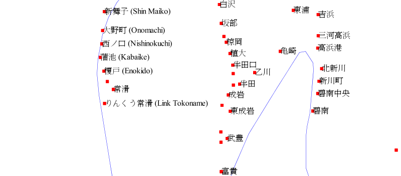

Hum, I used the OSM database dump you gave me some time ago,
setup a simple red dot + label style and looked over Japan with
it, and I'm getting the attached image, using the following wms
request:
http://localhost:8080/geoserver/wms?LAYERS=topp%3Aworld_boundaries%2Ctopp%3Aplanet_osm_point&SRS=EPSG%3A4326&HEIGHT=351&WIDTH=800&STYLES=,pointname&FORMAT=image%2Fpng8&SERVICE=WMS&VERSION=1.1.1&REQUEST=GetMap&EXCEPTIONS=application%2Fvnd.ogc.se_inimage&BBOX=136.75004405561768,34.82553207590814,137.05216646553882,34.95808828326105
Thought I'm not able to read Japanese, the labels look legit to me?
I also see the same chars appearing in the GetFeatureInfo response
of the GeoServer map preview.
I know that sometimes ago I installed extra-super-full i18n support
on my windows machine so I have special fonts and whatnot to support
most scripts around, but I did not do anything specific to Java itself.
Unfortunately I have no idea of what it would take to get the same
result on Linux or Mac OSX, simply never tried.
Cheers
Andrea
Andrea Aime
OpenGeo - http://opengeo.org
Expert service straight from the developers.
request:
Cheers
Andrea
Andrea Aime
