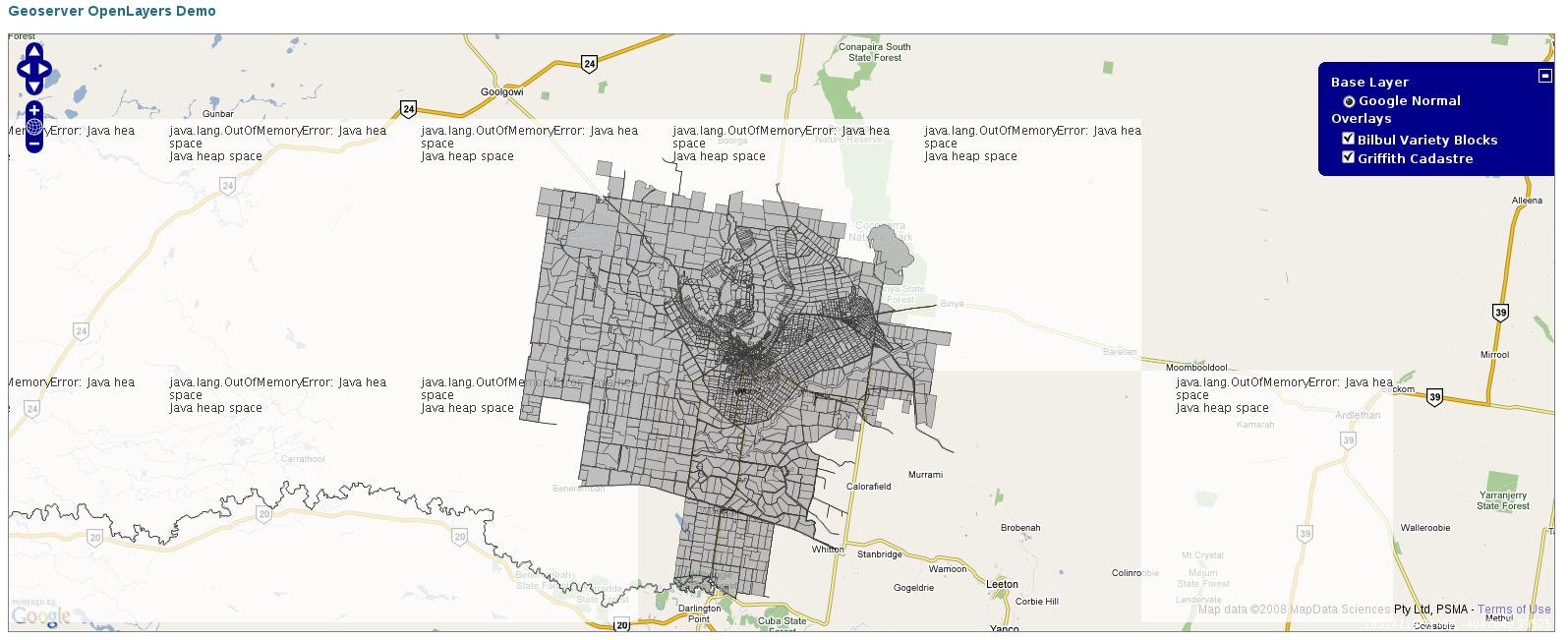

What I am trying to do is display several layers using openlayers and geoserver. This includes 1 Google Map layer and 2 WMS layers as outlined in attached picture. Code was modified from provided example.
However when I try this and use the map for a little while I get “java.lang.OutOfMemoryError: Java heap space” errors on both the map and in the console which is running geoserver.
I tried this in both the 1.7.0 and latest-trunk builds and the problem occurs in both.
It appears to work fine when I remove my wms layer which has a custom style applied. The other layer simply uses the polygon layer which comes with geoserver.

I second Stefan, it's most probably an issue with the permanent
generation memory setup. Are you running other apps alongside GeoServer
in the same web container?
Do you have a log of the full exception stack trace? It can be found
in the geoerver data directory logs/geoserver.log
Anyways, feeding your JVM with "-Xms48m -Xmx256M -XX:MaxPermSize=128m"
extra params should do the trick in most cases

Thanks adding those commands to the startup script appears to have fixed the problems for now.
