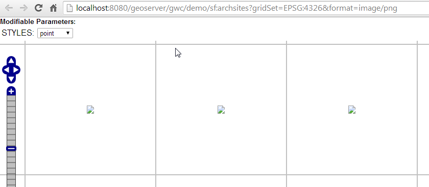

I am using GWC, Geoserver 2.5 integrated on Windows 8 with Tomcat/7.0.53
when i seed the layer nurc:Img_Sample png or jpeg format from the gwc demo page, I am getting error. Layer is not displayed.
Satır içi resim 1
i get error 400 null, when i check the link “http://localhost:8080/geoserver/gwc/service/wms?LAYERS=sf%3Aarchsites&FORMAT=image%2Fpng&SERVICE=WMS&VERSION=1.1.1&REQUEST=GetMap&STYLES=&SRS=EPSG%3A4326&BBOX=-103.8427734375,44.4287109375,-103.798828125,44.47265625&WIDTH=256&HEIGHT=256” and
geoserver logs ERROR [geowebcache.GeoWebCacheDispatcher] - null http://localhost:8080/geoserver/gwc/service/wms
Right click on one of those “images” and save the result, you will often find it is an service exception. In this case I would guess one of your styles is incorrect?
You could also confirm by issuing a single GetMap request from the layer preview screen, rather than going directly to open layers.
