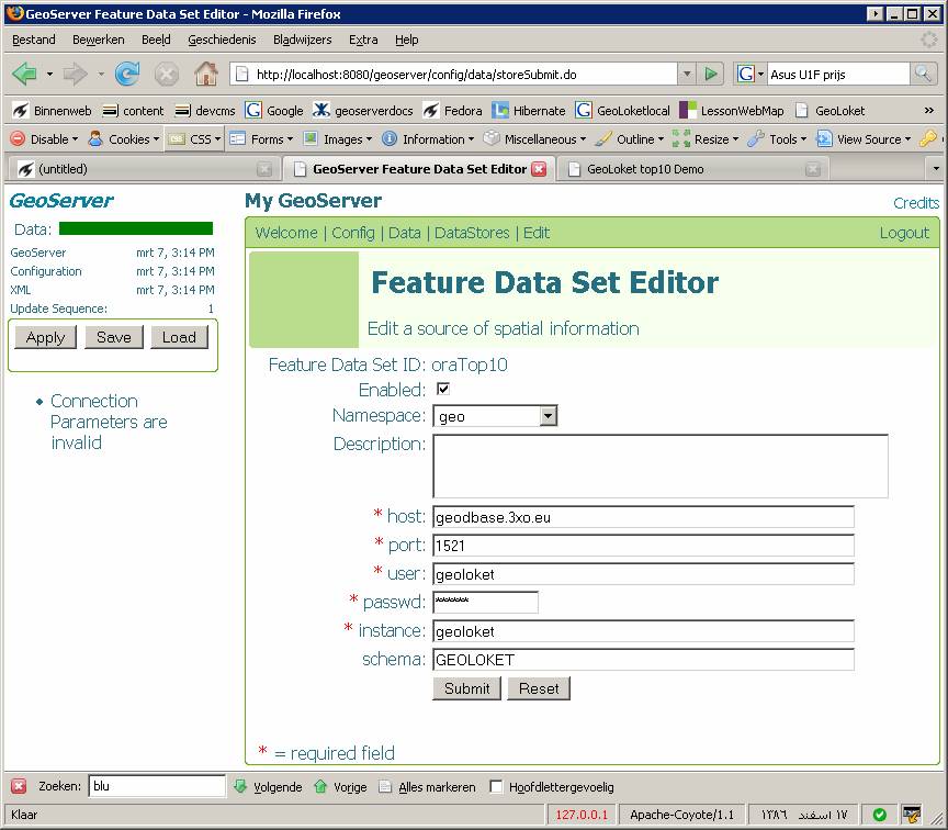

In Geosevre 1.6.1, when I want add a datastore form Oracle spatial. I recive following error in log file:
2008-03-07 15:18:06,212 INFO [geoserver.filters] - 127.0.0.1 "POST /geoserver/config/data/storeSubmit.do" "Mozilla/5.0 (Windows; U; Windows NT 5.1; nl; rv:1.8.1.12) Gecko/20080201 Firefox/2.0.0.12" "http://localhost:8080/geoserver/config/data/storeSubmit.do&quot;
2008-03-07 15:18:06,212 WARN [geotools.data] - Could not acquire Oracle Spatial Database:java.lang.NoClassDefFoundError: org/geotools/geometry/JTS$ReferencedEnvelope
            at org.geotools.data.oracle.OracleDataStoreFactory.createDataStore(OracleDataStoreFactory.java:177)
            at org.geotools.data.DataStoreFinder.getDataStore(DataStoreFinder.java:91)

I add plugin gt2-oracle-spatial.jar en ojdbc.jar.
Here is also melding in jsp:
I use same variable in geoserver 1.5.3, there is no problems:
Is something change in the new version?
It seems to me you used the Oracle plugin for 1.5.x into 1.6.x?
Each version of GeoServer has its own plugins, they are not compatible
with a different one.
If this is the issue, try downloading the Oracle plugin for 1.6.1
and see if it works fine.
Let me know if it works for you
Cheers
Andrea
Andera,
Thank you Andrea now it ‘s working, but there is nothing here in documentation over difference download possibility.
