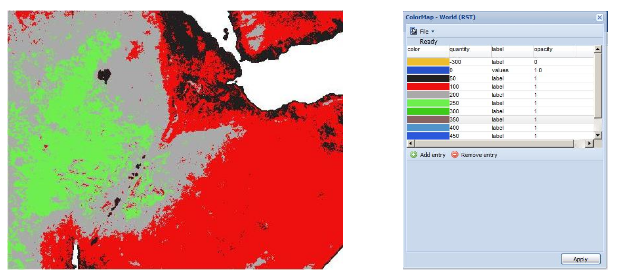

I am applying different styles in GeoServer for specific products like NDVI, RGB, etc. I usually refers to documentation and in this case I found something that is not clear from my understanding.
I am talking about ColorMap types in GeoServer, specifically the one below.
type="intervals" value means that each interval defined by two entries is rendered using the color of the first (lowest-value) entry. No color interpolation is applied across the intervals. Using the example set of color map entries:
The result image is:
Inline images 1
In my case, if I have the following interval:
  • 0.2 will give you “#530000
  • -0.9 will give you “#530000
And
  • -1 will give you … “#530000
It is only from -1.00001 that you will start to get “#003200
So the specified color applies only to values which are strictly smaller than the “quantity”.
My question is if this match the documentation.
Thank you,
Alberto

Thank you for the style.sld document and the info. I think this confirm what
we already believed, the specified color applies only to values which are
You are right, documentation is a bit confusing when it comes to <ColorMap
type="intervals">.
