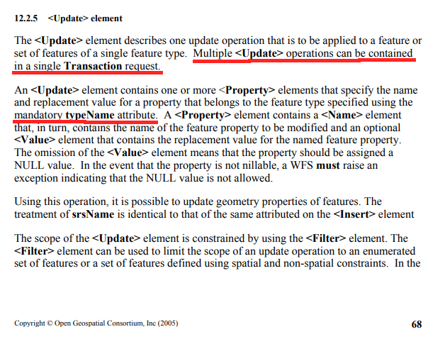

No I am trying to update features. If you look at the example that you shared, one has to create a clone in order to strip the boundedBy property from the feature.

You are trying to update features that did not exist in the first place, and that GeoServer is not aware…i’m a bit confused now :slight_smile:

so each update block has a different and valid fid?
This bit xmlns:feature=“FR_TEST” looks strange. What’s FR_TEST?
The wfs update examples I came across with only state the typeName property.
How did you create formatGML?
Vikram <vikram.eswar@anonymised.com…> escreveu no dia quarta, 22/01/2020 à(s) 14:20:
www.vfonsecaz.pt
as per WFS 1.1.0 specification
so i think you problem is similar to this
https://stackoverflow.com/questions/36145503/openlayers-3-ol-format-wfs-writetransaction-produces-incorrect-xml-for-simple-up
you should check formatGML. featureType should be FR_TEST:streets_freiburg" and featureNS a URI (Namespace URI)
Vitor Fonseca <vfonsecaz@anonymised.com> escreveu no dia quarta, 22/01/2020 à(s) 14:32:
