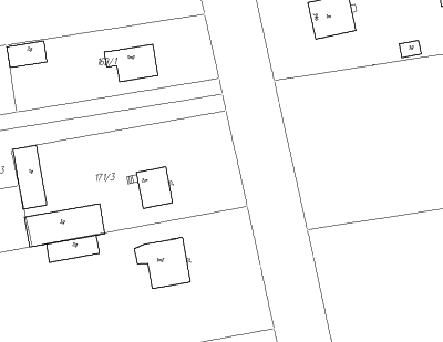

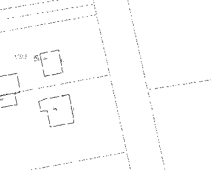

I have a problem with setting appropriate settings for layer, based on ImageMosaic with 1-bit monochrome rasters, that will give me on output WMS raster with good quality.
I attach screenshots of original raster in irfanview and in geoserver’s openlayer preview.
Default conf for this layer interpolation method was “nearest neighborhood” and this screenshots is from that conf. On bilinear it looks much worse.

Ciao Lukasz,
I would do what follows:
  • reprocess them as 8 bits performing a color expansion
  • add overview with bilinear or bicubic resampling
If you don’t want to do that, you may want to try and ask the imagemosaic to expand the palette to RGB but without proper overviews quality will suffer anyway.

2015-02-25 15:31 GMT+01:00 Łukasz Łagosz <lukaszlagosz@anonymised.com>:
Hi Simone
reprocessing to 8bit - no way (other app is using this rasters and thats way they have to be 1bit)
I tried to add overview to that one sample raster and add it to new datastore in Geoserver and preview in WMS - quality is still poor.
but wat do you mean saying “you may want to try and ask the imagemosaic to expand the palette to RGB” ?
Łukasz

Łukasz
Łukasz
Hi Simone
Łukasz

Łukasz
2015-02-25 15:31 GMT+01:00 Łukasz Łagosz <lukaszlagosz@anonymised.com..>:
Hi Simone
but wat do you mean saying "you may want to try and ask the imagemosaic
to expand the palette to RGB" ?
Łukasz
