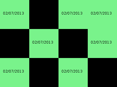

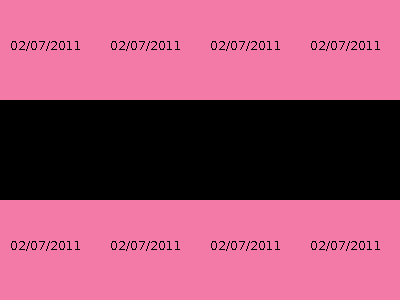

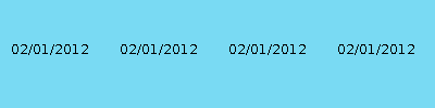

Following on from my experiments with image mosaics and partial updates last week I think I’ve hit a bug (or I still don’t understand the spec). Given the following mosaics at times as shown:
Inline images 2
Inline images 3
Inline images 4
Inline images 5

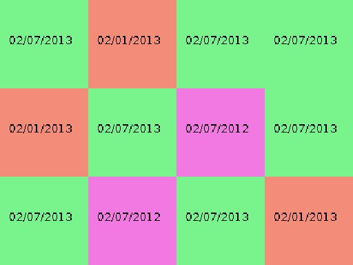

When I request a WMS with time=2010-01-05/2013-08-05 I get the following (infact I get this image for all end times after 2010-01-05,2012-01-05)
Inline images 6
Is this a bug or is there some switch I need to set that forces the latest granule to be returned instead of a random one? If it is a bug I’ll file a JIRA and see if I can fix it :slight_smile:
cheers
Ian

On Mon, Nov 18, 2013 at 2:25 PM, Ian Turton <ijturton@anonymised.com> wrote:
On 18 Nov 2013 13:21, "Andrea Aime" <andrea.aime@anonymised.com> wrote:
> Hi Ian,
> did you enable the time dimension in the "dimensions" tab of the layer
configuration?
Yes and I've been experimenting with the presentation choice but it seems
to make no difference.
Sorry, trying to help but really doing something else, so I may be missing
something.
The black areas you have in the original images, are they really
transparent?
If so I guess the code it's working as expected, it's mosaicking on all the
granules
in the time range you specified, with no particular order.
The notion of "give me the most recent in the range" is understandable, but
I don't believe
it's part of the standard, and maybe not always desirable either.
That said, we have a variable to control how many granules are
used, MAX_ALLOWED_TILES,
which can be set to 1, and then you can use SORT_BY, where you can set the
value
"sortVariable" or "sortVariable,A", "sortVariable,D" to control the sorting
order.
I just don't remember if they are both exposed by the GeoServer UI
Cheers
Andrea

Hi guys,
There is a SORTING parameter in the MosaicConfiguration exposed by the GS GUI which should do that.
Cheers,

Thanks for your help guys - I knew this had to be possible. For anyone who stumbles on this thread latter the correct syntax for the sorting param is varname (ingestion) D (that is space D) - I’ll try to update the docs later as there is currently no mention of the sorting param.
Inline images 1
Thanks
Ian

If so I guess the code it’s working as expected, it’s mosaicking on all the granules
The notion of “give me the most recent in the range” is understandable, but I don’t believe
it’s part of the standard, and maybe not always desirable either.
That said, we have a variable to control how many granules are used, MAX_ALLOWED_TILES,
which can be set to 1, and then you can use SORT_BY, where you can set the value
“sortVariable” or “sortVariable,A”, “sortVariable,D” to control the sorting order.
I just don’t remember if they are both exposed by the GeoServer UI
Cheers
Andrea

Documentation PR at https://github.com/geoserver/geoserver/pull/402 if some one wants to review it.
Ian
Inline images 1
Thanks
Ian
Ian Turton
On 18 November 2013 13:50, Daniele Romagnoli <daniele.romagnoli@anonymised.com> wrote:
Hi guys,
Cheers,
Daniele
