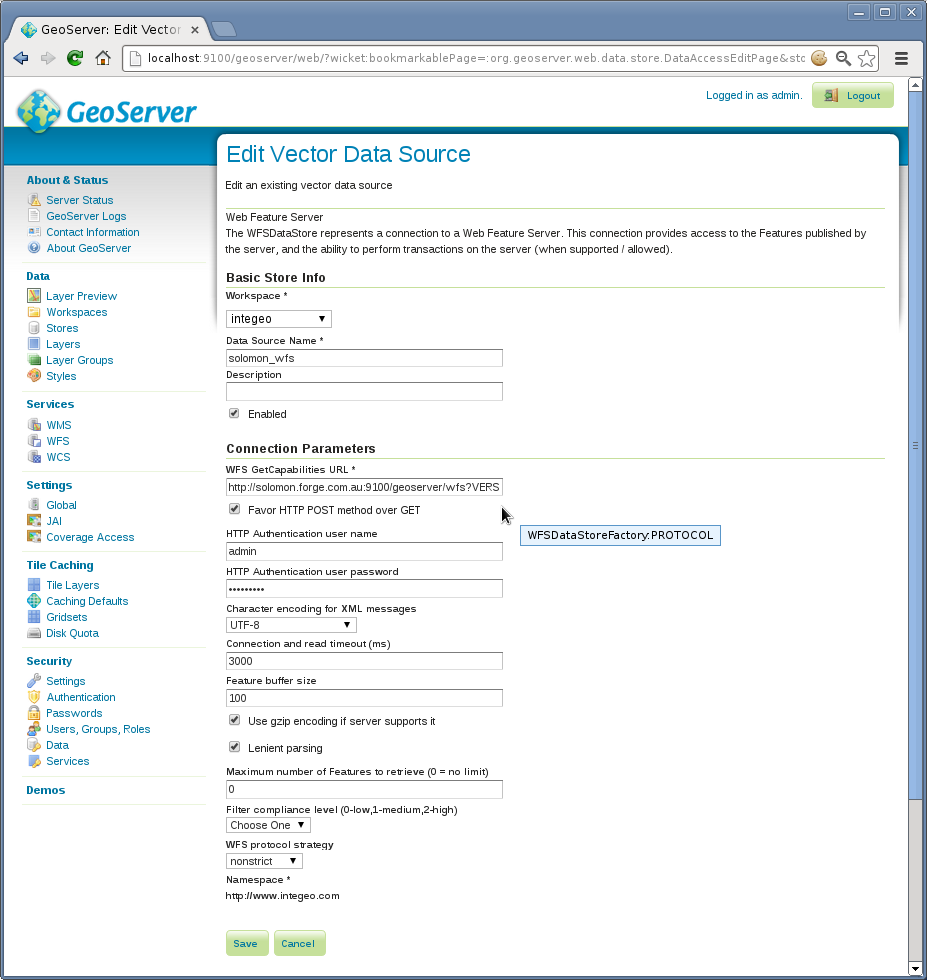

where xxx:yyy is the shapefile-store layer being referenced by the
target wfs-store based layer i'm previewing.
However, one of the fixes we made in 2.2.4 was exactly to wipe out
Filter.INCLUDE
from the filter encoding chains, so I'm curious as to how it got
there.
my data-store was originally the one i was using w/ pre 2.0 releases.
with every release of GeoServer i copy/rename the folder so as to keep
distinct data-dir copies for each version of GS.
one thing worth noting, but i'm not sure it has any bearing on this
issue, is that after every restart of GS, the WFS-store is disabled and
i have to re-enable it from the GUI before testing. the log shows that
when the WFS-store is first resolved, the referred layers (shapefile
ones) are not yet known, which explains the failure and the need to
re-enable.
Is it something we can reproduce, by getting access to the WFS server,
the SLD, and the WMS request that triggers this?
the servers are running on my development machine itself behind a
firewall. i can post/upload the base shapefile (but i don't think the
shapefile itself is causing this since it works fine w/ all 2.2.x
releases) and screen shots of the GUI for integrating the layers
(shapefile and wfs stores) into GS. let me know how you want to

I'm afraid we can't proceed, without access to that WFS server there
is nothing I can do.
i'll see what i can do for setting up such a server, but would
appreciate it if you can try reproducing yourself; see later...
Out of curiosity, what is the other WFS server? Another GeoServer?
Something custom built?
i mentioned it before in my original email: there's only one geoserver
(2.2.4); w/ 1 wfs data-store referencing itself; the GetCapabilities
URL being:
http://solomon.forge.com.au:9100/geoserver/wfs?VERSION=1.0.0&REQUEST=GetCapabilities
and exposing (through the WFS store) one shapefile based region layer.
i've attached a screen-shot of the WFS data store screen in the GUI.
Monday here down-under is a public holiday so it may be some time mid
next week before i have a server accessible to you --unless you can
reproduce it on one of your servers.
thanks again for your time.
Cheers
Andrea

Ah, ok, missed this bit. You got yourself an unsupported configuration,
GeoServer cannot reference itself… I’m actually surprised it does not lockup
completely while trying to build the WFS internal schema description,
as such code might cause a infinite loop (in order to respond to a
DescribeFeatureType request GeoServer needs to build the in memory
representation of all feature type schemas, which in turns makes the
WFS store do a DescribeFeatureType against the same GeoServer,
and so on).
That’s also why the store gets disabled every time you restart GeoServer,
the store checks the remote WFS server is online, but it’s not because
GeoServer is still starting up
Cheers
Andrea

Thank you, the nightly build is working for me :slight_smile:
Notice: I had to set the "WFS protocol strategy" to "nonstrict" to get it
working.
Regards
Paul
