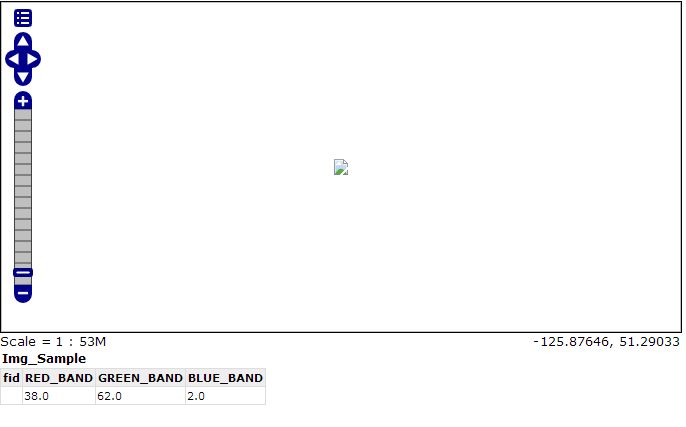

[Geoserver-users] Preview layer shows only missed image icon
HI.
I’ve installed Geoserver on Windows 7. I installed too JDK 7 and have same result, so I read in a forum that i had to change the version to jdk-6u37-windows.
I did It but still having same issue… I tried to preview all the layers that install by default and nothing, blank map.
In fact I clicked on the link to download KML file, and open in Google Earth an its empty, doesn’t show but it appears like a layer on the left panel.
Can you give me some tips?
Thanks in advance

Hi… nop, is not the same issue. I haven’t recieve any error, only a blank map with the missing image icon at the center. In fact, I can click in the blank map and give me the right data table, only does not display the map.
Thanks in advance

HI.
Its local… I only see the blank map with the missed image icon at center. If I move the mouse over the blank map, data at the bottom with the Lon Y Lat changes.
Thanks in advance

If you right-click on the map and check properties, you should get the url of the image and then test this url. I think It’ll give you more info on what’s causing the problem.
Are geoserver local or from another server ?

A few questions:
-1- what kind of data are talking about?
-2- did you actually opened up the geoServer logs?

On Tue, Feb 26, 2013 at 8:51 PM, aldo lavin <aldolavin@anonymised.com> wrote:
HI.
Its local... I only see the blank map with the missed image icon at center.
Lat changes.
I've installed Geoserver on Windows 7. I installed too JDK 7 and have same
jdk-6u37-windows.
I did It but still having same issue... I tried to preview all the layers
an its empty, doesn't show but it appears like a layer on the left panel.
Thanks in advance

Hi…
When I install geoserver, creates too 20 layers by default. I think that all of them are examples.
I can’t see any of them.
I created a layer from PosGis and same result, I cannot see it.
In log file, the only error I can see is "2013-02-26 21:48:19,630 ERROR [geoserver.ows] - "
Thanks in advance.

A few questions:

HI.
Lat changes.
Thanks in advance

When you had Java 7 installed, could it have been related to this issue?
http://comments.gmane.org/gmane.comp.gis.geoserver.user/35646
I had the same problem, although on Windows Server 2008. Installed JDK 7 on
another machine, then copied the PYCC.pf file to my production JRE, then
restarted Tomcat. Working fine now. Even though you stated the JDK was
installed, I would check to make sure that file exists.

Hi Aldo,
How did you install GeoServer? did you use the war, the exe?
Which OS? Did you try the preview with which browsers?
Try to compress the full log and add to your email or post it on a
repository freely accessible.

HI…
I installed geoserver on Win, uising .exe.
I attach the log file and the image that I see when I try to preview any layer.
Thanks.

HI.
center.
Y
Lat changes.

Hi Aldo,
The problem is here:
2013-02-27 11:41:47,924 ERROR [geoserver.ows] -
java.lang.NoClassDefFoundError: Could not initialize class
org.geotools.image.ImageWorker
  at org.geoserver.wms.map.PNGMapResponse.formatImageOutputStream(PNGMapResponse.java:117)
  at org.geoserver.wms.map.RenderedImageMapResponse.write(RenderedImageMapResponse.java:122)
  at org.geoserver.ows.Dispatcher.response(Dispatcher.java:912)
It seems strictly related to discussion in this thread:
Are you too using Java 7? In this case are did you installa full JDK or a JRE?
