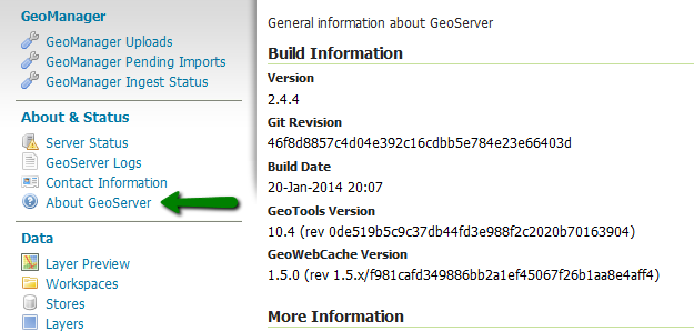

Rick,
Under the “About & Status” header should be a link to “About GeoServer” and looks like the picture below (or attached). If this link doesn’t exist, I surmise you have a fairly old GeoServer installation and the instructions Ben provided will be the best way to determine the version.
