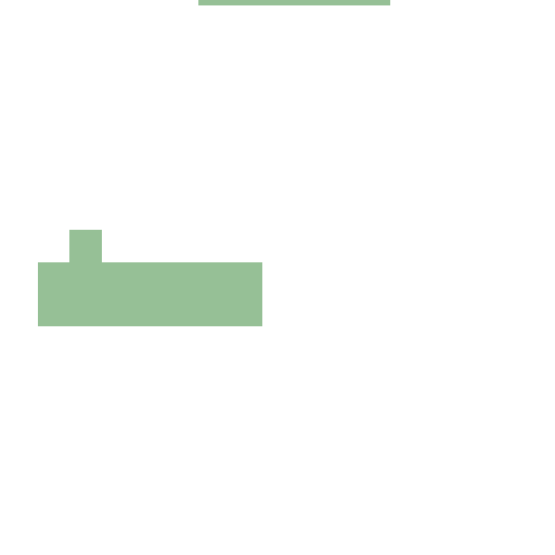

I have an oracle georaster being accessed via the Image Mosaic JDBC plugin (version information below). The georaster is stored in EPSG:4326. I have an openlayers client with a tiled wms layer that displays the data in EPSG:900913.
The issue I am having is that the tiles requested by openlayers appear to have a slight overlap at the edges.
As an example the following two requests are for adjacent tiles (one just north of the other). In the northern tile there is a green area that stops just short of the bottom of the tile while in the southern tile the green area extends into the top of the tile slightly.
Northern tile
/geoserver/wms?LAYERS=nafi%3AFire%20Scars%20by%20Month%20Current&TRANSPARENT=TRUE&SERVICE=WMS&VERSION=1.1.1&REQUEST=GetMap&STYLES=&FORMAT=image%2Fpng&SRS=EPSG%3A900913&BBOX=14793316.704141,-1291480.0297266,14798208.67395,-1286588.059917&WIDTH=512&HEIGHT=512
(Attached as northern_tile.png)
Southern tile
/geoserver/wms?LAYERS=nafi%3AFire%20Scars%20by%20Month%20Current&TRANSPARENT=TRUE&SERVICE=WMS&VERSION=1.1.1&REQUEST=GetMap&STYLES=&FORMAT=image%2Fpng&SRS=EPSG%3A900913&BBOX=14793316.704141,-1296371.9995361,14798208.67395,-1291480.0297266&WIDTH=512&HEIGHT=512
(Attached as southern_tile.png)

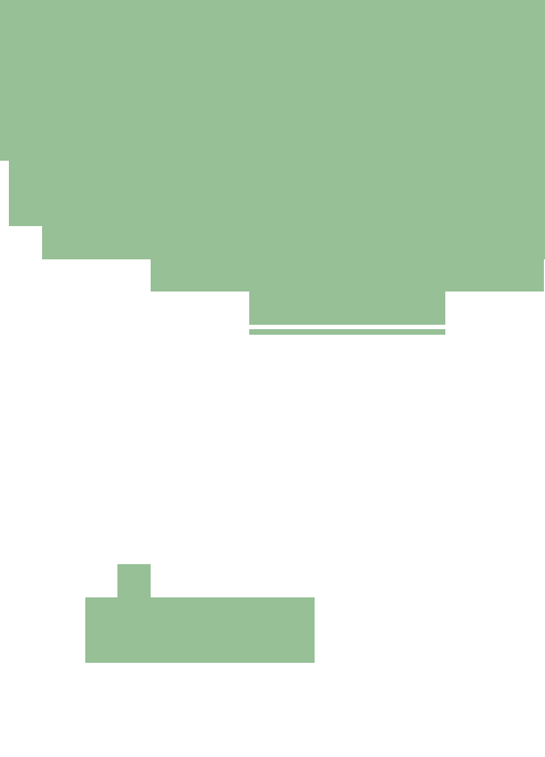

So when viewed in openlayers it appears like:
(Attached as open_layers.png)
Note the green sliver at the bottom of the top green area.

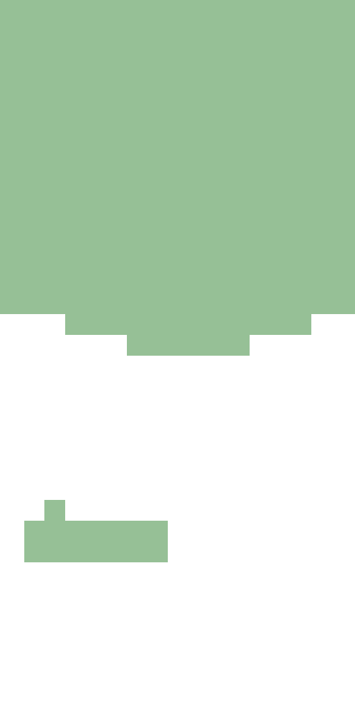

This artifiact is not coming from the data itself, as can be seen by requesting the two areas together.
/geoserver/wms?LAYERS=nafi%3AFire%20Scars%20by%20Month%20Current&TRANSPARENT=TRUE&SERVICE=WMS&VERSION=1.1.1&REQUEST=GetMap&STYLES=&FORMAT=image%2Fpng&SRS=EPSG%3A900913&BBOX=14793316.704141,-1296371.9995361,14798208.67395,-1286588.059917&WIDTH=512&HEIGHT=1024
(Attached as combined.png)
Note that there is no gap/sliver in the bottom of the top green area.
You can see that the BBOXes share a common edge. The bottom of the northern tile (-1291480.0297266) is the same as the top of the southern tile (-1291480.0297266).
