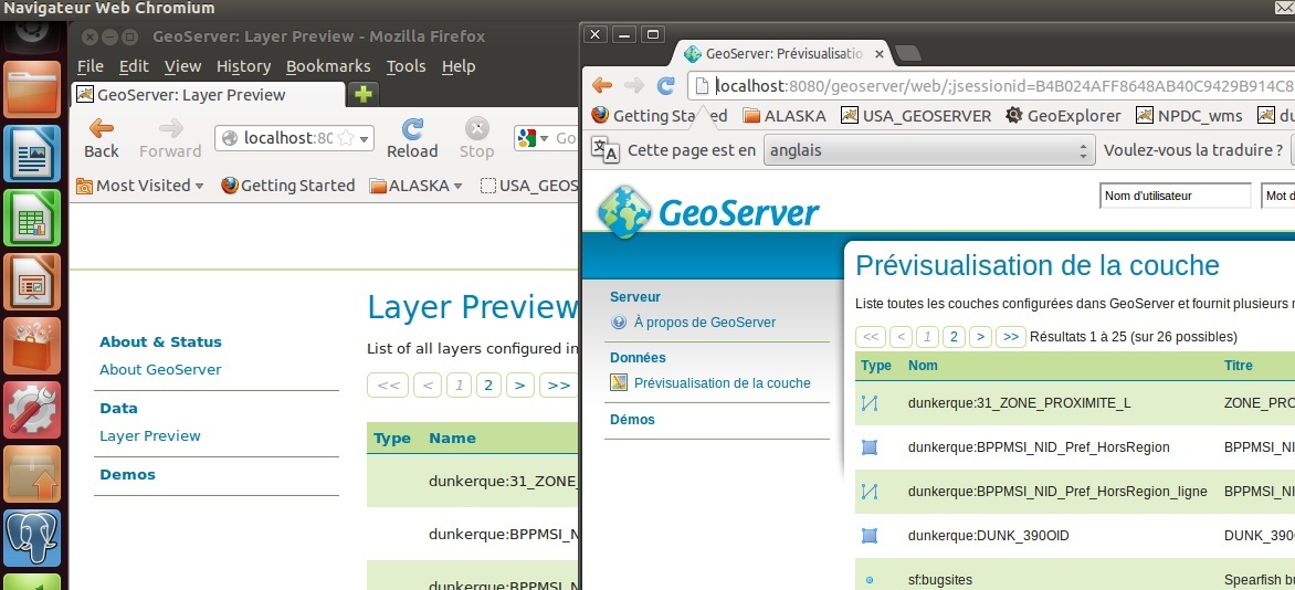

Hi Anne,
I got the same error about HTML character encoding, but I can see the map.
On the Firebug console if you switch to the net panel you should see
at least two requests, the one with the request=GetMap key-value pair
is about the map.
Can you find it there?
And if yes can you try to execute as a stand alone request to see if
GeoServer return you the map?
Kind Regards,
Stefano

2012/12/7 Quesnel Anne <aquesnel@anonymised.com>:
Ok,
from one example tiger-ny
I see only your first request comparing to your picture console
1)Get wms?service GetMap
(http://localhost:8080/geoserver/wms?service=WMS&version=1.1.0&request=GetMap&layers=tiger-ny&styles=&bbox=-74.047185,40.679648,-73.907005,40.882078&width=354&height=512&srs=EPSG:4326&format=application/openlayers)
2) get wms?LAYERS ==>there is nothing
and others you can see on attached picture
ok, your Browser seems stop working after the two css errors.
Sorry for missing this point before :frowning:

Dear Stefano!
It works: to display maps with the openlayer links from an other browser
(Chromium on ubuntu)! thank you
But, it could be interesting to resolve this css problem of Firefox
browser for continue working with it and firebug tool during geoserver
session.
Have nice week end
Kind Regards,
Anne Q

Hi Anne,
It does not seem really a Firefox issue. I used it on Windows 7 and
Linux Mint with the OpenLayers layer's preview. On both I am using
Firefox 17.0.1 release.
I don't remember of this issue with older Firefox version, but
honestly I can't say I did test layer's preview against all Firefox
release.
From the screen shot I see you are using Ubuntu with unity windows
manager, could you check your Firefox release?
Have a nice day

Dear all,
The graphical interface appears different and better (chromium) if you
compare it with firefox .
The firefox version I used was 15.0.1 and I updated the firefox browser
into 17.0.1 but the
symbology type is always missing on the left of the mapping preview window
Best Regards
Anne Q
