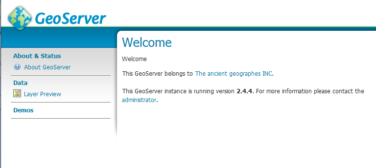

I want to restrict users to read/write layers, create stores only in a special workspace. This sounds quite easy, however I’m stuck with a problem here.
I created a new user (let’s call it “gyakornok”) together with a new role (“ROLE_GYAKORNOK”), and assigned this role to the new user. Only this role is associated with him.
I also edited the layers.properties file, which now looks like this:
..r=ADMIN
..w=ADMIN
topp.*.r=ROLE_GYAKORNOK
topp.*.w=ROLE_GYAKORNOK
mode=HIDE
So what I want is that only the “topp” workspace should be visible and editable by my new user.
If I successfully log in with the new user, however, the left panel is almost completely empty, I can only see the “Layer preview” option, but there is no option to modify/add/delete layers, stores etc. I attach the image of this part of the screen.
Why is that? What did I wrong?
almost completely empty, I can only see the "Layer preview" option, but
Read and Write rights are about the data, not the configuration.
In order for a user to edit a workspace you have to give him admin rights
instead
Cheers
Andrea

Hello Andrea,
I’m a bit confused now. What is the point of giving W rights to users when I cannot see any writing (adding layers, modifying layers, adding stores etc.) options after logging in?I don’t wish to give admin rights to the new user, hence he/she would be able to modify his/hers role quite easily. This would be a major security risk.
I’m pretty sure there is a solution for my problem which is maybe too obvious for me to see.

On Fri, May 23, 2014 at 11:43 AM, Gergely Padányi-Gulyás <fegyi001@anonymised.com
wrote:
Hello Andrea,
I'm a bit confused now. What is the point of giving W rights to users when
WFS-T, editing data
I don't wish to give admin rights to the new user, hence he/she would be
risk.
Any chance in the geoserver configuration is admin, you need admin rights,
which can be limited to a workspace (that user won't be able
to change the global configuration, the users, and other workspaces)
Cheers
Andrea

Andrea,
Thank you very much!
I didn’t notice the “a” option. What I had to do is simply add “a” rights to the workspace in addition to “r” and “w”.
Now the new user can only see the limited number of workspaces.
