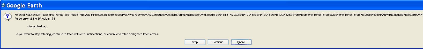

The problem appears when I apply it in GeoServer. uDig and OpenLayers interact with it through WMS just fine. However, QGIS gets bounding coordinates wrong and behaves rather strangely with it and Google Earth gives this error (‘mismatched tag’ if you don’t get the screendump image), looks like GeoServer’s not generating good KML:
Here are the GeoServer Demo links to the layer in question and attached is the sld file. I wonder if it is an SLD version issue?
