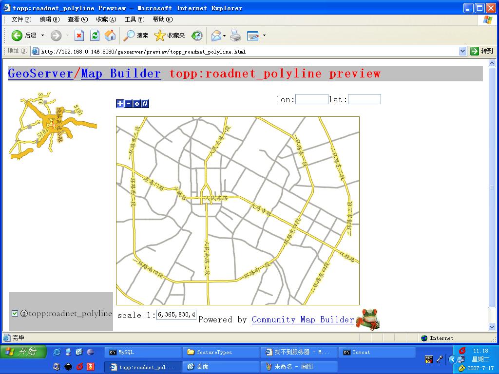

Alex Chew ha scritto:
Hi,Andrea
Attached two picture on the same scale but with different rendering on JDK1.4 and JDK1.6.
Attached roadnet3.sld is the SLD file I used,roadnet.sql is GIS data on postgis.
I am still be confused and have no idea at all.

Alex,
the file did not get thru completely, so I don't have the full map,
yet I have at least part of the roads in the portion you provided,
and I always see them the same way as you do with jdk 1.6.
I'm missing the SRS of that data btw.
But anyways, the scale denominators you included in are impossible to reproduce in a real map unless you are doing the carthography of a city of ants... I mean, all scale denominators are less than 100 or so, while I expect the carthography of a city to use denominators like 100,000 and above (your screenshots report 1:3,000,000,000 or so), so I don't really see how any featuretypestyle other than what you named "level5" can ever be activated.
