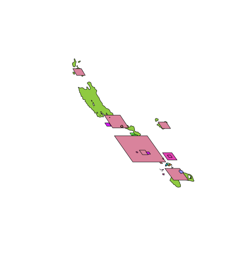

Ciao Andrea,
thank you very much for testing the SLD 1.1.0 file and shapefile.
I was using GeoServer 2.6.3. You gave me the idea to upgrade to 2.7.0 and GeoServer is using SLD vers. 1.0.0 and 1.1.0, now. See my screenshot for you.
Maybe GeoServer was not able to send the attributes of column ‘feature designation’ correctly because of wrong GeoServer configuration in 2.6.3. I migrated between GeoServer 2.5.x and 2.6.x and can’t set the “STRICT_PATH java system property variable” to “true” because I’m not sure how to perform this. http://docs.geoserver.org/stable/en/user/datadirectory/migrating.html#migrating-between-geoserver-2-5-x-and-2-6-x
Perhaps, setting STRICT_PATH java system property variable is obsolete in GeoServer 2.7.0. Is it?
Now, I have to fix my OpenLayers2 application because it doesn’t use customized SLD styles. Neither vers. 1.0.0 nor 1.1.0…

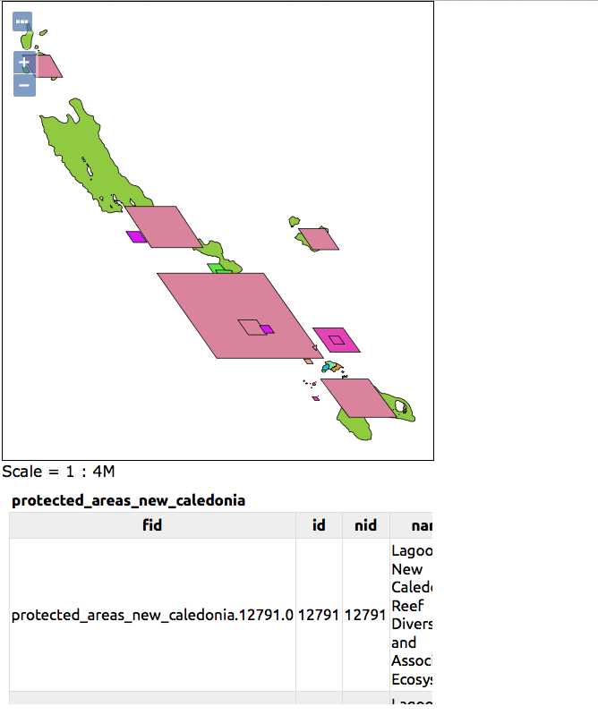

Ciao
mumble mumble… ho configurato i dati con il tuo stile, ed ecco la mappa:
Mi pare che funzioni come dovrebbe… o no?
Che versione di GeoServer stai usando?
Ciao
Andrea
