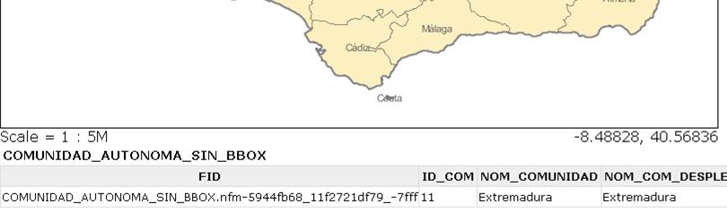

Firstly, when I make a GetFeatureInfo request, it appears an attribute "FID" that does not exist in our Oracle DB. Could it be possible to hide this information?
I have read that a solution to hide attributes is to create a view in our DB, but I do not know if GeoServer admits views without ID (actually the primary key of the table). We are not interested to show neither ID nor FID in GetFeatureInfo responses. (1)
Another question regarding GetFeatureInfo is related to the name of the Featuretype. Could I change the name of the Featuretype instead of using the one from the DB view? In the Admin Tool there is a field called "Alias", I am not sure if this is related with this issue, but it does not work anyway. (2)

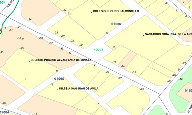

The last question is related to the configuration of priorities when the different layers are drawn. In one layer we have the house numbers and in other one we have the street names. I have designed the corresponding SLD so at certain scales both layers are shown, and always appear a lot of house numbers and few street names. I have changed the font size of the labels but it only improved a little. Is there a way to reverse this situation? What I do not want is to get names and numbers overlapped, but I think street names are more important than house numbers and I would prefer to show those when there was a lot of information. Could it be related to the order in the WMS? Or to some vendor option of text symbolizer element in SLD?
I attach an example very illustrative: you can see a lot of house numbers but the street names are not shown; only when you are at a big scale they begin to appear.
information?
(2)
Hola Rubio,
the template you are using is just a default/demo geoserver template.
Check out this to create your own template:
http://geoserver.org/display/GEOSDOC/GetFeatureInfo+templates
begin to appear.

The fid is an internal reference that GeoServer uses. Ideally it should be of the form <feature type>.<primary key value>. If the primary key is not accessible then it's not really a meaningful thing.
The alias field is meant for requests, so instead of asking for the layers=someprefix:some_very_confusing_acronym you can just ask for layers=roads , but I'm not sure that this will be reflected in the getfeatureinfo.
Please have a look at the following page, it explains how you can format the output and omit fields: http://geoserver.org/display/GEOSDOC/GetFeatureInfo+templates
Just to clarify. FID is something required by the WFS spec to publish. And gets reported in various WMS outputs as well. Interally GeoServer looks for a primary key on the table to generate the FID.
So if you really want to hide it from all services, creating a view (or changing the key structure of the table), is the best option. However if you only care about GetFeatureInfo then templates will work.

Firstly, when I make a GetFeatureInfo request, it appears an attribute “FID” that does not exist in our Oracle DB. Could it be possible to hide this information?
Use the templates or custom code as others have said, no matter what
a Feature will always have an identifier, based on a primary key or
just made up to make the WFS standard happy, there's no way to actually
remove, but as others said you can make up a template that just does
not display the FID.
Another question regarding GetFeatureInfo is related to the name of the Featuretype. Could I change the name of the Featuretype instead of using the one from the DB view? In the Admin Tool there is a field called “Alias”, I am not sure if this is related with this issue, but it does not work anyway. (2)
Alias is really a misnomer, when you set it, it's really the new name of
the layer, not an alternate way to call the layer. that is, it makes
the native name disappear completely and takes its place.
There are two ways to achieve this:
- flip the order so that strees get drawn before house numbers. Labels
   are drawn in the order the layer they come from appear, so lower
   layers always get their label drawn, the others fight with the
   space left free by them
- use the Priority SLD option to change the order in which the labels
   are drawn, see the documentation here:
   http://geoserver.org/display/GEOSDOC/LabelingOptions
Cheers
Andrea
