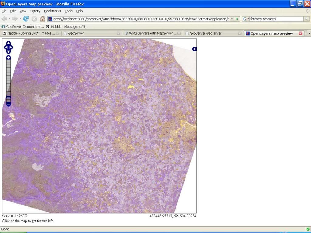

Well, it is more an tiff encoding problem that anything else.
maybe your geotiff encode your values as signed int, and geoserver interprets it as unsigned int
can you give me the output of gdalinfo on your image?
Gersh
On Jan 16, 2008 12:12 PM, Jon Britton <man_kills_everything@anonymised.com> wrote:
It seems then that there’s no way to dispaly this data correctly in
GeoServer. GeoServer treats lower values as lighter colours, so if I get 0
or <0 as my minimum value in my NIR band I get white instead of black. This
means even if I switch my bands around manually (using GDAL or something)
then things which have a low NIR value (such as water) will display
incorrectly.
Does anyone know of a way around this? I don’t really want to create a load
of RGB images just for display purposes and I don’t have any software to do
this anyway.
Thanks,
Jon
Gersh
wrote:
It seems then that there's no way to dispaly this data correctly in
0
This
incorrectly.
Does anyone know of a way around this? I don't really want to create a
load
of RGB images just for display purposes and I don't have any software to
do
this anyway.
Thanks,
Jon

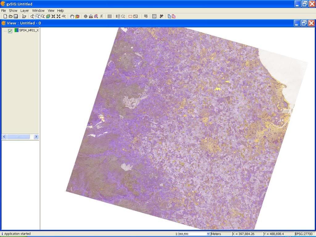

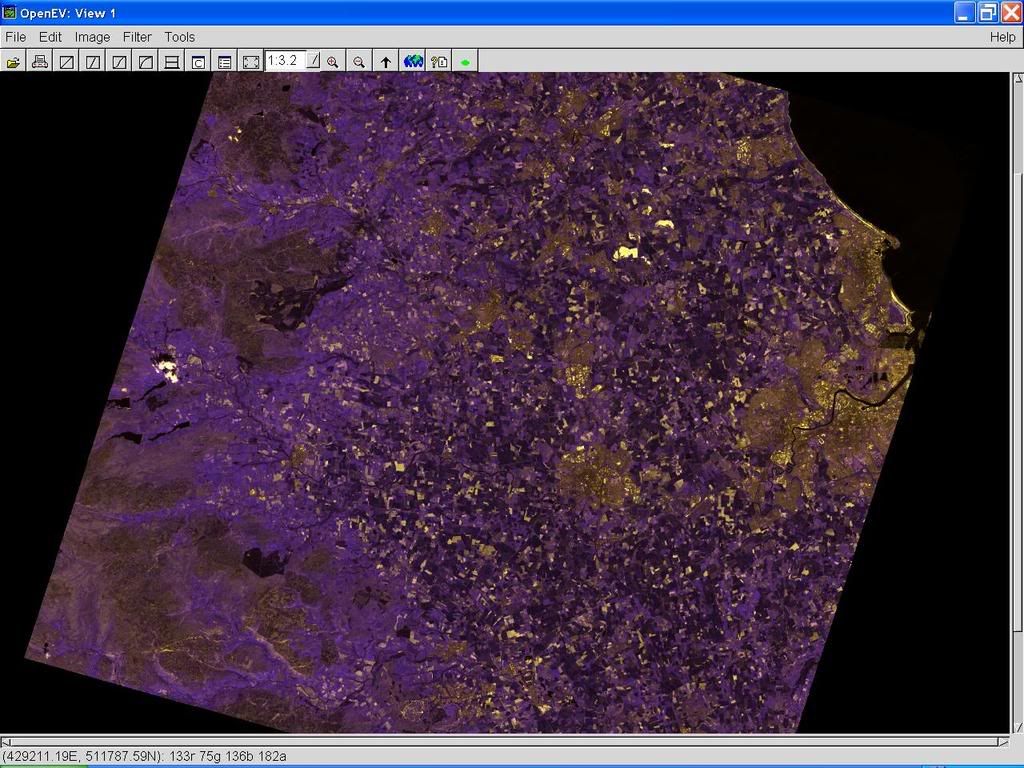

Hmm, strange,
did you try to visualise the geotiff with another viewer (openEnv for instance, shiped with FWtools) to see whether you have the same problem. I there is no problem, then it is a bug from geoserver. Could be the alpha masking…
gersh

Yes, in fact, OpenEV is the only thing I have that displays it as I would
expect. I've also got gvSIG which displays it in the same way as GeoServer.
Here are some screenshots of how the same image appears in each (all using
default settings, I just loaded it up then took the picture).
http://i256.photobucket.com/albums/hh190/dead_passive/geoserver.jpg
http://i256.photobucket.com/albums/hh190/dead_passive/gvsig.jpg
http://i256.photobucket.com/albums/hh190/dead_passive/openev.jpg
gvSig also makes the images transparent even if there is not transparency
setting. This is sort of similar to what GeoServer does when I add the image
as an overlay.
expect. I’ve also got gvSIG which displays it in the same way as GeoServer.
as an overlay.

Hi,
I tried using a black background in gvSIG thinking it would produce a
similar output to OpenEV, but it doesn't. I just want a result similar to
what is shown here :http://www.science.edu.sg/ssc/imgs/3834/xs321.gif
I'm not sure if this is actually a bug as such. The data values in a SPOT
image can be negative and I think that GeoServer is treating anything <= 0
as no data. This would make sense for normal RGB images where all valid
values are > 0 but not really for other data. OpenEV seems to automatically
adjust for this.
Does this sound possible?

Hmm, I'm pretty sure now that the problem is that GeoServer is treating the
4th band as some sort of alpha or opacity. I was wrong about the negative
values since all of my values are positive, the problem is that it seem to
makes areas that should be darker more transparent! And of course, where the
first three bands have lower values, the 4th will probably also have a low
value - creating this transparent effect.
I'm going to try and remove the 4th band from one of my images and see if it
displays differently in GeoServer.
Thanks,
Jon
0
automatically
adjust for this.
thanks,
Jon

> On Jan 17, 2008 10:48 AM, Jon Britton
would
>> GeoServer.
>> using
transparency
>> image
>> as an overlay.
>> Thanks,
>> Jon
