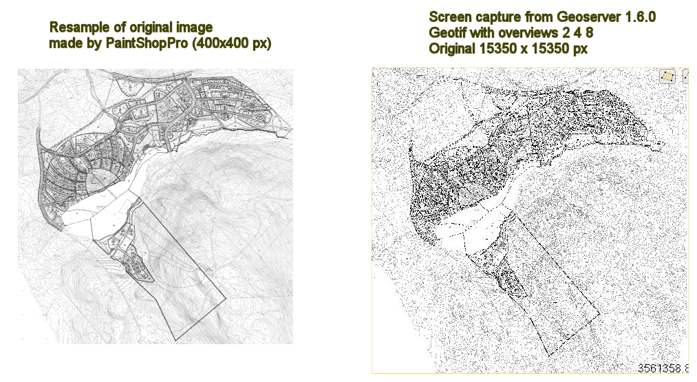

Lehtonen, Mika ha scritto:
I meant that transparency thing. I haven't got it working. And because I use lots of bilevel files, life is getting unpleasent. Overlapping images can't be used and no overlaying. Switching opacity in SLD won't solve anything but can be used while testing.
Has anybody else experience of transparent coverages, that is rasters?
I've tried to force a transaprency in a binary image I have with the following command:
gdal_translate -a_srs myfile.prj -a_nodata 0 myfile.tif output.tif -co "NBITS=1" -co "TILED=YES" -co "COMPRESS=DEFLATE"
and gdal_info on the output looks like:
Driver: GTiff/GeoTIFF
Files: cn.tif
Size is 4972, 10953
Coordinate System is:
PROJCS["Monte Mario / Italy zone 1",
     GEOGCS["Monte Mario",
         DATUM["Monte_Mario",
             SPHEROID["International 1924",6378388,297.0000000000014,
                 AUTHORITY["EPSG","7022"]],
             AUTHORITY["EPSG","6265"]],
         PRIMEM["Greenwich",0],
         UNIT["degree",0.0174532925199433],
         AUTHORITY["EPSG","4265"]],
     PROJECTION["Transverse_Mercator"],
     PARAMETER["latitude_of_origin",0],
     PARAMETER["central_meridian",9],
     PARAMETER["scale_factor",0.9996],
     PARAMETER["false_easting",1500000],
     PARAMETER["false_northing",0],
     UNIT["metre",1,
         AUTHORITY["EPSG","9001"]],
     AUTHORITY["EPSG","3003"]]

Of what I am a little bit worried is the rendering of these lineart rasters.
Using overviews makes zoom out view even worse. Take a look at the image I
attached. I know this is a difficult job and there are only few lineart
raster users like me I guess but still there might be some work to do. I am
using fixed resolutions which may not be a good idea?
Would it be better to use autoresolution? If the overview resolution would
fit into the screen resolution, the outcome would be much better, isn't that
right?

Mika,
mi impression is that GeoServer is taking the fast route for rendering,
that is, subsampling from the last overview, and you don't have enough overviews (try gdalinfo on that file, the smallest overview should still
very big, something like 2000x2000).
I'd suggest ou ramp up the overviews up to 64 (2 4 8 16 32 64) and
the rendered quality should improve.
Cheers
Hi,
first of all, the original issue; I got it solved, I want to believe so anyway. I am using apache cocoon (fop/batik) for pdf generation and received valuable information from cocoon-users list. Big rasters come out at least 14000x14000 px size through wms (4G RAM). And it seems that tommy is stable and won't hang anymore.
Second issue: in order to keep overview that big (2000x2000) I can only use parameters like 2 3 4 6 8 in gdaladdo. Using something like 64 makes smallest overview from 15000 px to be 234 pix.
Using non power of 2 overviews level is useless. Try 2 4 8 16 32.
Anyway the outcome is bad when zooming out. These overviews should be filtered with blur, soften or whatever one calls it, filter. That is the answer I believe. But how to do it without using any GUI raster manipulator? Gdaladdo won't do it; average and nearest method are the only parameters which can be applied.
Can Geoserver use a separate overview file? It would be easier to filter overviews separately; since we are talking about multipage tif, right? Any idea? Please remember, that I don't want the "original" raster to be filtered. The best printing is made from sharp original; softening mixed with a printers rasterizing won't produce the best result.
No, GeoServer cannot use external overviews. But I guess you might try
something like this:
* create scaled down versions of your data, by powers of 2, using a
   professional photo editing software and then convert them to geotiff
   using gdal_translate
* associate each one with an SLD that has a strict scale rendering rule,
   something like
   <Rule>
     <MinScaleDenominator>1000</MinScaleDenominator>
     <MaxScaleDenominator>2000</MaxScaleDenominator>
     <RasterSymbolizer>
* make a GetMap request that lists all the "oveview" layers one
   on top of the other, if the scale rules are properly set, only
   one will be drawn (you can also set up a layer group to allow
   using just one layer)
And finally transparency; any new information about it?
None, I'm too busy to work on it right now and Simone did not answer either. If you're in a hurry you may want to consider commercial support, try to contact either Chris Holmes (cholmes at openplans dot org) or Simone Giannecchini (simboss1 at gmail dot com) for a quote.
Cheers
Andrea
Oh, forgot one thing. Did you enable the bilinear interpolation in the
WMS configuration panel?
Cheers
Andrea
