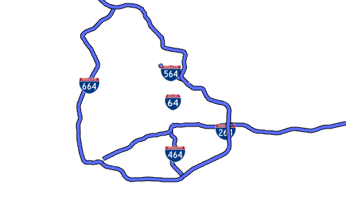

I am trying to stylize an interstate. In my SDL I have a rule for the LineSymbolizer and then I have a rule to place the Interstate Shields as a graphic image onto the roadway. The SLD is:
<?xml version="1.0" encoding="UTF-8"?>
Other Roadway Centerlines #000000 5 butt miter 0.0 #5A6EFF 3 butt miter 0.0 Roadway - Shield I-64 rte_nbr 64 0 1200000 t image/png 1.0 24 Roadway - Shield I-264 rte_nbr 264 0 1200000 image/png 1.0 24 Roadway - Shield I-464 rte_nbr 464 0 1200000 image/png 1.0 24 Roadway - Shield I-564 rte_nbr 564 0 1200000 image/png 1.0 24 Roadway - Shield I-664 rte_nbr 664 0 1200000 image/png 1.0 24
The problem I am having is that the graphics seem to be being place at the center of the feature shapes and not on the line itself. I’ve attached a sample screenshot. Any idea what I am doing wrong? Any other thoughts on how to approach this problem? Thanks in advance,
