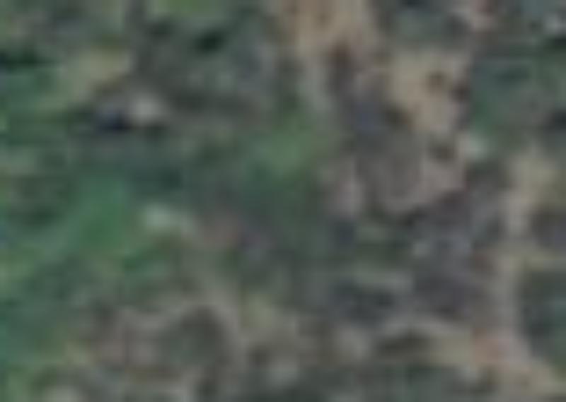

Ciao Simone,
Sure, a picture here is worth 1000 words:
1.7.5 latest nightly, Bilinear Interpolation set in "Web Map Server Rendering", using mosaicking, zoomed way in:
1.7.3, everything the same:
I think you will see what I mean.
Roger

Ciao Simone,
Roger

On Thu, Jun 18, 2009 at 11:18 AM, Roger Bedell<sylvanascent@anonymised.com> wrote:
Ciao Simone,

Ciao Simone,
Roger

Ciao Simone,
Interpolation is now working fine when zoomed in. However, interpolation is
not working when zoomed out and using overviews. Here are two images, one
from 1.7.3 and one from last nights build. I think you will see the
difference.
Thanks for all your help!
Roger

Ciao Simone,

http://www.geo-solutions.it
http://simboss.blogspot.com/
http://www.linkedin.com/in/simonegiannecchini
On Sun, Jun 28, 2009 at 8:50 AM, Roger Bedell<sylvanascent@anonymised.com> wrote:
Ciao Simone,
Yes, interpolation now works at all zoom levels in latest nightly.
Thank you!
Roger

Ciao Roger,
I have just committed a few more improvements, now things should be
fine. Please, keep me posted with your tests.
Simone.
