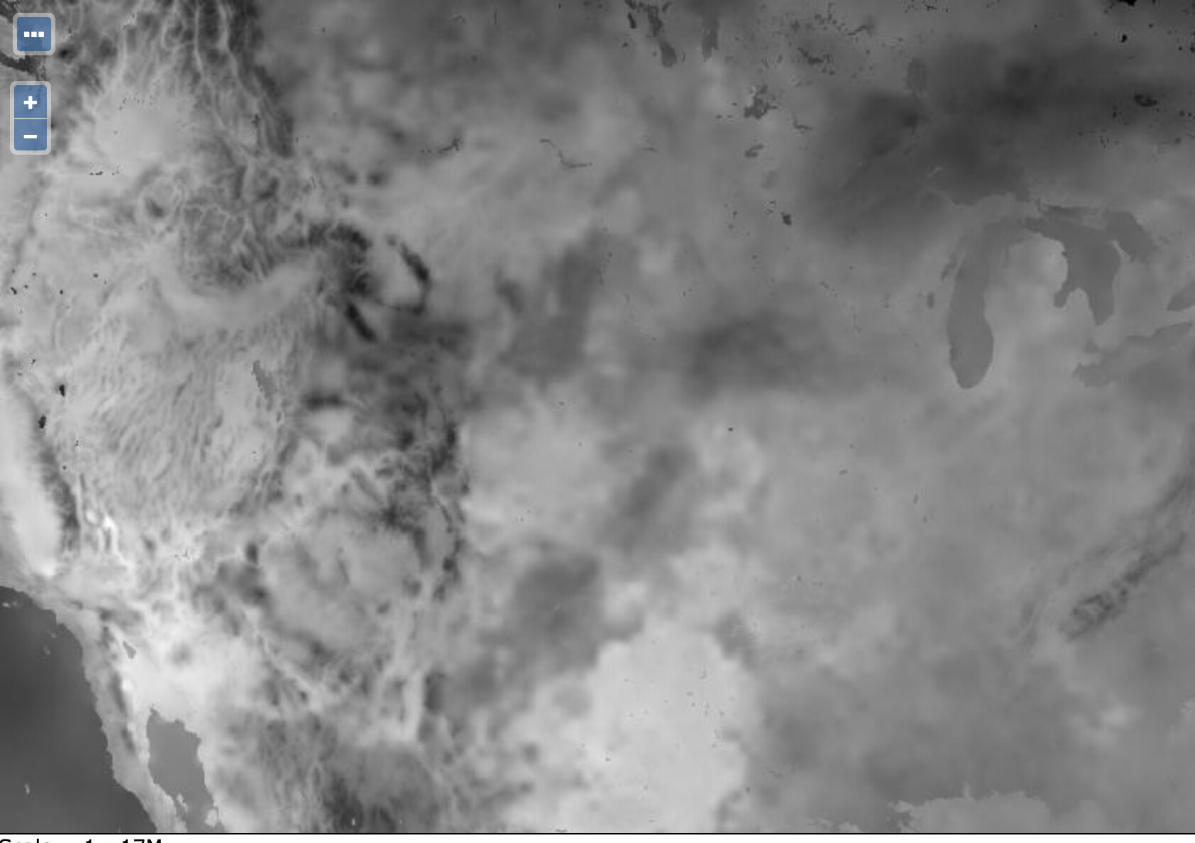

Hi again Steve,
I’m able to get the grib file you posted rendering. I didn’t use PostGIS, since I don’t have time to add a custom projection right now (I assume you have a custom projection added), but I did try to add it to PostGIS to see what the results would be on the insert and it seems that Time does get correctly added:
15 Aug 13:32:08 DEBUG [geotools.jdbc] - Inserting new feature: INSERT INTO “public”.“Temperature_surface” ( “the_geom”,“location”,“imageindex”,“time” ) VALUES ( ST_GeomFromText(‘POLYGON ((-4228647.898383763 -835237.3149693012, -4228647.898383763 4370737.742215395, 3252718.9433056377 4370737.742215395, 3252718.9433056377 -835237.3149693012, -4228647.898383763 -835237.3149693012))’, 999004),‘/Users/devon/Data/grib-postgres/hiresw.t00z.arw_5km.f00.conus.grib2’,0,‘2016-08-11 17:00:00.0’)
I did get it rendering using the H2 data store however:
Inline image 1
(Looks kind of ugly cause I didn’t bother changing the style)
A couple questions:
  • Did you make sure to enable the time dimension in the layer publishing config?
  • Which versions of GeoTools/GeoServer are you running? I’m only testing against master right now, I can maybe check it out in older versions later when I have more time. I know Ben has fixed some bugs in this area lately.
Here are the configs I used:
https://gist.github.com/dvntucker/9824309a09a86a28f76e9d6ef117221f
Cheers
Devon Tucker
Software Engineer
Boundless Spatial

Steve,
Yeah, downloading exactly what you posted seems to work for me, and AFAICT my versions are the same. This is the result I get in the layer preview:
https://www.dropbox.com/s/xszfdwhrb5s1ar7/Screen%20Shot%202016-08-15%20at%204.52.30%20PM.png?dl=0
Maybe the missing piece is the custom projection I added, perhaps there’s a difference there. I added this to my user_projections/epsg.properties:

Hi again Steve,
A couple questions:
Cheers

From: Devon Tucker [mailto:devonrtucker@anonymised.com]
Sent: Monday, August 15, 2016 4:56 PM
To: Ferguson, Steve -FS <sferguson@anonymised.com>
Subject: Re: [Geoserver-users] Working Grib2 data source does not work as image mosaic
Steve,
1000003=PROJCS[“lambert_conformal_conic_1SP”, GEOGCS[“unknown”, DATUM[“unknown”, SPHEROID[“unknown”, 6371229.0, 0.0]], PRIMEM[“Greenwich”, 0.0], UNIT[“degree”, 0.017453292519943295], AXIS[“Geodetic longitude”, EAST], AXIS[“Geodetic latitude”, NORTH]], PROJECTION[“Lambert_Conformal_Conic_1SP”], PARAMETER[“central_meridian”, -95.0], PARAMETER[“latitude_of_origin”, 25.0], PARAMETER[“scale_factor”, 1.0], PARAMETER[“false_easting”, 0.0], PARAMETER[“false_northing”, 0.0], UNIT[“m”, 1.0], AXIS[“Easting”, EAST], AXIS[“Northing”, NORTH], AUTHORITY[“EPSG”,“1000003”]]
Do you have a custom projection added for this data?
A couple questions:
