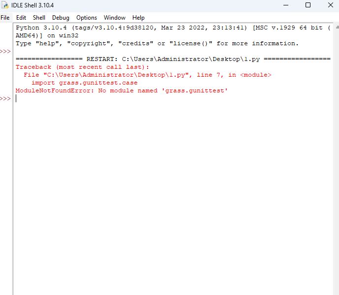

I also tried to run locally and installed grass, pytest, ipython packages using pip but it gives grass.gunittest module not found error
Running pytest should not give you “grass.gunittest not found” because grass.gunittest is not used when running pytest. (Note that you need the latest code from the main branch to run pytest otherwise pytest will fail with lots of errors.)
Anyway, the important step likely missing is that you need to add GRASS Python packages on path.
I run pytest on Ubuntu with the following:
PYTHONPATH=grass --config python_path:$PYTHONPATH LD_LIBRARY_PATH=/path/to/compiled/grass/dist.x86_64-pc-linux-gnu/lib pytest /test/file/to/run/name.py -vv
Or, in multiple steps:
export PYTHONPATH=grass --config python_path:$PYTHONPATH
export LD_LIBRARY_PATH=/path/to/compiled/grass/dist.x86_64-pc-linux-gnu/lib
