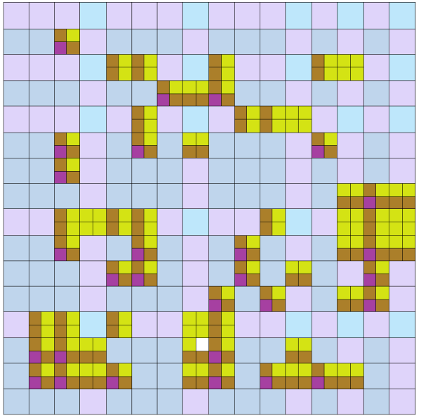

I would be interesting in developing a C version, that had some additional
functionality, and could output GRASS polygons. Also- I think that the
algorithm has some kind of rounding or indexing errors, as I see systematic
variation in areas of the quadrants (see attached).
