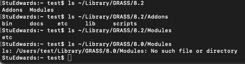

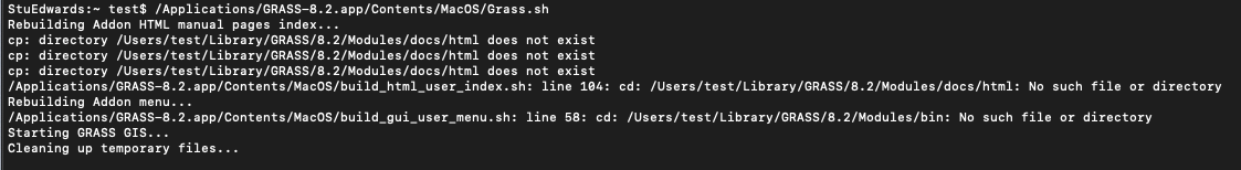

Yes, very strange. I am able to open it with no problem in a ‘clean’ partition that I keep for testing. But there is an odd prequel to the actual opening:
where some library files seem to be missing. The Library file structure for 8.2 is different from previous versions in that there is the addition of ‘Addons’ that contains most of the directories previously contained in ‘Modules’. This appears to be why the startup shell can’t find the ‘docs’ directory.
The above is from my test partition and that’s why there’s no 8.0. This probably does not affect my problem although there is one reference to the gui_user_menu.sh that might be relevant.

I just looked at my ~/Library folder.
I have …/GRASS/8.2/Addons but nothing is in it. My addons are all in ~/Library/GRASS/8.2/Modules. I did not move them to there manually.
I vaguely remember a bit of discussion some months back about changing where addons are stored. This may be related. If anyone remembers that discussion it would be good to relook at it.
Michael

I moved all the directories in ~/Library/GRASS/8.2/Addons into /Modules and it fired up right away… with no error messages at all.
Hope this doesn’t break something else -
Stu
<Screen Shot 2022-06-08 at 9.19.03 AM.png>
<Screen Shot 2022-06-08 at 9.22.54 AM.png>
I replaced my grassdata directory with a new empty one and get the same ‘bad magic number in ‘wx’ : b’\x03\xf3\r\n’ ’ error.
Remarkably this is not a unique problem:
