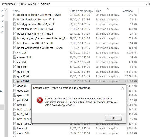

Hum, it can be related, because starting GRASS with
grass --text
and then
v.buffer
I get a windows message saying that the gdal300.dll is missing. However, I have a gdal300.dll file in OSGeoW folder: C:\OSGeo4W64\bin.

Hi Markus and Markus,
I hope someone else can test, because here in my machine:
  • GRASS 7.8.1 standalone 64bits does not work;
  • GRASS 7.8.0 standalone 64bits work fine;
  • GRASS 7.8.1 from OSGeo4W64 does not work, also inside QGIS;
  • GRASS 7.8.0 from OSGeo4W64 does not work, also inside QGIS;
  • GRASS 7.8.1 installed with QGIS 3.4.13-2 and QGIS 3.10.0-2 does not work, also inside QGIS;
  • GRASS 7.6.1 installed with QGIS 3.4.13-1 and QGIS 3.10.0-1 work fine, alone and inside QGIS.
In all of them, when I try to run any GRASS algorithm from grass78 --text, I get the gdal300.dll error.
Best regards,
Pedro

Hi Pedro,
- GRASS 7.8.1 standalone 64bits does not work;
- GRASS 7.8.0 standalone 64bits work fine;
- GRASS 7.8.1 from OSGeo4W64 does not work, also inside QGIS;
- GRASS 7.8.0 from OSGeo4W64 does not work, also inside QGIS;
- GRASS 7.8.1 installed with QGIS 3.4.13-2 and QGIS 3.10.0-2 does not work,
also inside QGIS;
- GRASS 7.6.1 installed with QGIS 3.4.13-1 and QGIS 3.10.0-1 work fine,
Try dependency walker called from the GRASS prompt and load gdal300.dll.
There's probably something missing that the dll needs or conflicting in
system32 that takes precendence over something shipped with OSGeo4W (see also
[0])
Jürgen
[0] https://github.com/qgis/QGIS/issues/26891#issuecomment-495889169

try:
(1) add following lines in C:\OSGeo4W64\bin\grass78.bat
@echo off
rem
rem #
rem # GRASS initialization bat script (OSGeo4W)
rem #
rem
rem
rem Set environmental variables
rem
call "%~dp0\o4w_env.bat"
call py3_env.bat
call "%OSGEO4W_ROOT%\apps\grass\grass78\etc\env.bat"
@echo off
rem do a dependency walk
rem add these 2 lines here
for %%d in (%GISBASE%\lib\*) do depends /c /f:1
/ot:%APPDATA%\GRASS7\depwalk_lib.log %%d
for %%e in (%GISBASE%\bin\*) do depends /c /f:1
/ot:%APPDATA%\GRASS7\depwalk_bin.log %%e
rem
rem Launch GRASS GIS
rem
"%GRASS_PYTHON%" "%GISBASE%\etc\grass78.py" %*
rem
rem Pause on error
rem
if %ERRORLEVEL% GEQ 1 pause
(2) start OSGeo4W winGRASS7.8.1; you have to wait some minutes while
dependency walker is working
(3) go to %APPDATA%\GRASS7 (just copy/paste this into the windows explorer);
here it opens as C:\Users\YourUsername\AppData\Roaming\GRASS7
(4) in this folder, there are 2 files:
depwalk_lib.log
depwalk_bin.log
(5) open these 2 files in a texteditor, e.g. notepad++ and search for gdal3,
here e.g. in depwald_lib.log:
          [ 6] c:\osgeo4~1\apps\grass\grass78\lib\LIBGRASS_GPROJ.7.8.DLL
               [ E ] c:\osgeo4~1\apps\msys\bin\LIBINTL-8.DLL
               [ ^6] c:\windows\system32\KERNEL32.DLL
                    [F^6] c:\windows\system32\NTDLL.DLL
               [ ^6] c:\windows\system32\MSVCRT.DLL
               [ ^6] c:\osgeo4~1\bin\PROJ_6_2.DLL
               [ ^6] c:\osgeo4~1\bin\GDAL300.DLL <<==
               [ ^6] c:\osgeo4~1\apps\grass\grass78\lib\LIBGRASS_GIS.7.8.DLL
that means LIBGRASS_GPROJ.7.8.DLL is looking for GDAL300.DLL in
c:\osgeo4~1\bin\
best regards
Helmut
Sent from: http://osgeo-org.1560.x6.nabble.com/Grass-Dev-f3991897.html

try to type into the OSGeo4W shell:
C:\>where gdal300.dll
result here:
C:\OSGeo4W64\bin\gdal300.dll
best regards
Helmut
Pedro Venâncio-2 wrote
Hi Helmut,
What is gdalinfo --version in the OSGeo4W shell telling?
C:\OSGeo4W64>gdalinfo --version
GDAL 3.0.2, released 2019/10/28
and type the same in a normal windows console, here:
C:\Users\myusername>where gdal300.dll
INFORMATION: no file with this pattern could be found
best regards
Helmut

Do you see anything suspicious?
The message I get (screenshot attached) is something like “It was not possible to find the entry point of the procedure curl_mime_init in the DLL C:\OSGEO4~1\bin\gdal300.dll”.
Thanks!
Nothing obvious
The message I get (screenshot attached) is something like "It was >not
possible to find the entry point of the procedure curl_mime_init >in the DLL
C:\OSGEO4~1\bin\gdal300.dll".
ok, I think we're narrowing down the issue now.
I've seen there was a curl update today in OSGeo4W 64bit. please try to
update your OSGeo4W environment and try again to start winGRASS in OSGeo4W.
Otherwise, open a ticket in OSGeo4W for the gdal curl issue.
best regards
Helmut
