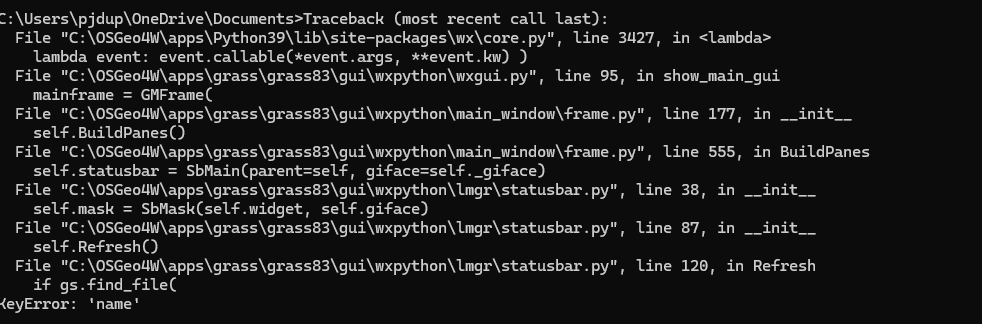

In desperation I am posting to this list. I have posted on the OSGeo4W list a week ago to no avail.
I hope someone can help me.
On a clean install of OSGeo4W (and for that matter standalone QGIS and GRASS installers), I get the following error (see attached screenshot) starting any version of GRASS.
On GRASS 7, I can do a mapset selection before crash, but the other 2 just crashes.
Install is on a machine that ran GRASS up until a week ago, until I uninstalled the OSGeo4W stack, and deleted everything. There is nothing strange about my Windows Setup
I hope anyone can help me, and I hope you can see the screenshot.

Hi Jeff
Thanks for the link. I installed the 8.4 dev version. and it gives exactly the same error as with GRASS standalone from grass,osgeo.org, GRASS installed with OSGeo4W, and from the QGIS standalone installer.
I am now suspecting that it might not be the wxpython included in the installers, but my pc itself.

Windows issues are hard to debug as most of developers are on Linux boxes.
Do you have an ArcGIS install by any chance? In the past ArcGIS was a
source of different problems for GRASS as it would register its Python
globally and then GRASS would pick wrong Python version resulting
myriad of strange errors.

Hi Maris.
Yes I always had ArcGIS installed and it has never given any issues with GRASS.

Even if the GUI doesn’t start, could you still type in:
g.findfile element=cell file=MASK
and also:
g.gisenv
and see what you get?
