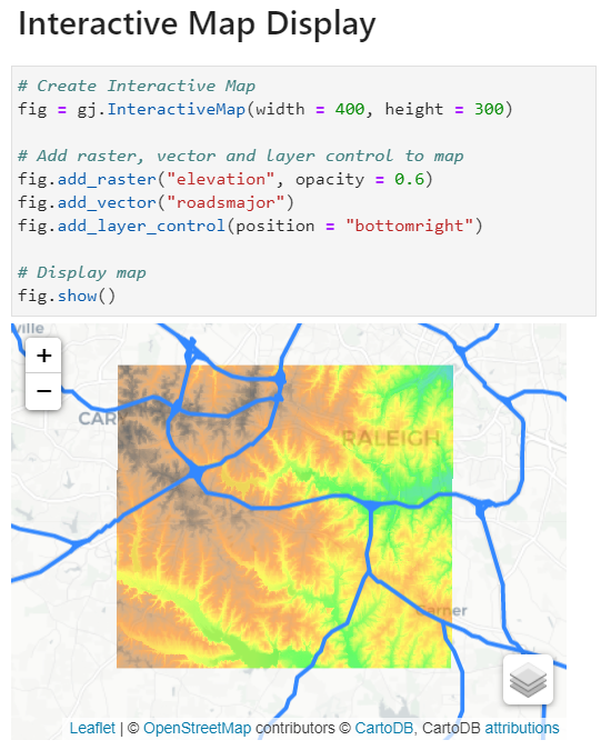

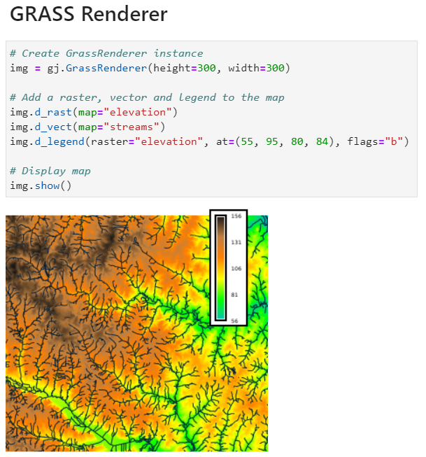

This project introduces a new subpackage for GRASS GIS, grass.jupyter that improves the integration of GRASS GIS with Jupyter Notebooks. The grass.jupyter subpackage introduces a new startup function, init(), and two display classes, GrassRenderer and InteractiveMap, specifically for making the usage of GRASS in Jupyter more simple and intuitive. GrassRenderer renders GRASS maps as PNG images and InteractiveMap displays rasters and vectors interactively with folium [1], a leaflet library for Python.

The previous integration of GRASS GIS and Jupyter Notebooks required a cumbersome environment variable setup after launching GRASS from within the notebook. There is an external python library grass_session that can be installed to shorten this launch substantially but, as an external library, it is not included in a typical GRASS install. Additionally, maps were rendered as PNG images using a relatively unintuitive sequence: calling d.erase, then modules from the display family and finally rendering the image with IPython.display.Image(). There was also no simple way to zoom or toggle between layers.

With the help of my mentors, I introduced a new package grass.jupyter that contains a new init() function to shorten the launch and two display-related classes, GrassRenderer and InteractiveMap. GrassRenderer wraps the previous approach, rendering PNG images but with a more intuitive syntax. InteractiveMap, the other display-related class in grass.jupyter, allows users to view GRASS vectors and rasters in folium, a leaflet library for Python. After creating an instance of InteractiveMap, users can add vectors and rasters with add_vector() and add_raster(). Users can also add a layer control element with add_layer_control().
