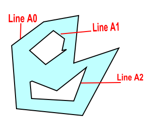

Hi,
I'm almost done with the new v.buffer module, but I need some help to finish it.
I have the following problem. Suppose we have several line_pnts
structs: A0, A1, A2, ...., An; B0, B1, B2, ..., Bm; ... (All lines are
not self-intersecting) Here A0, B0, ... represent outer contours of
areas and A1...An, B1, ... Bm, .... represent the corresponding isles
(and no two isles A1...An intersect each other, and no isle of A1...An
intersects A0. I.e. we have nice areas). How to create the map which
consists of the union of those areas A,B,... (Most of the times
A,B,... will intersect each other)
I have attached an example of such area - A with outer line A0, and
isles A1, A2.
Impatiently,
Rosen Matev
(attachments)
drawing.svg
And here is png version for convenience
(attachments)

Hmm the old v.buffer seems to work it so that it creates a line consisting of all points including the islands (note that island points are listed counter-clockwise). This will create bridges to the islands. Those are removed with a call to Vect_remove_bridges(); so I guess you don't need to worry about them.
Markus, Glynn, Hamish, is that right? Is there no way to create islands without creating bridges?
--Wolf

can you reuse v.overlay code for that?
i.e. if you pass A and B into "v.overlay opt=or" do you get the
result you want? islands should be respected that way.
Hamish
I came up with something similar to v.overlay and the old buffer
module. I'm only concerned that it might be slow but I think we can
use a spatial index to improve it alot
