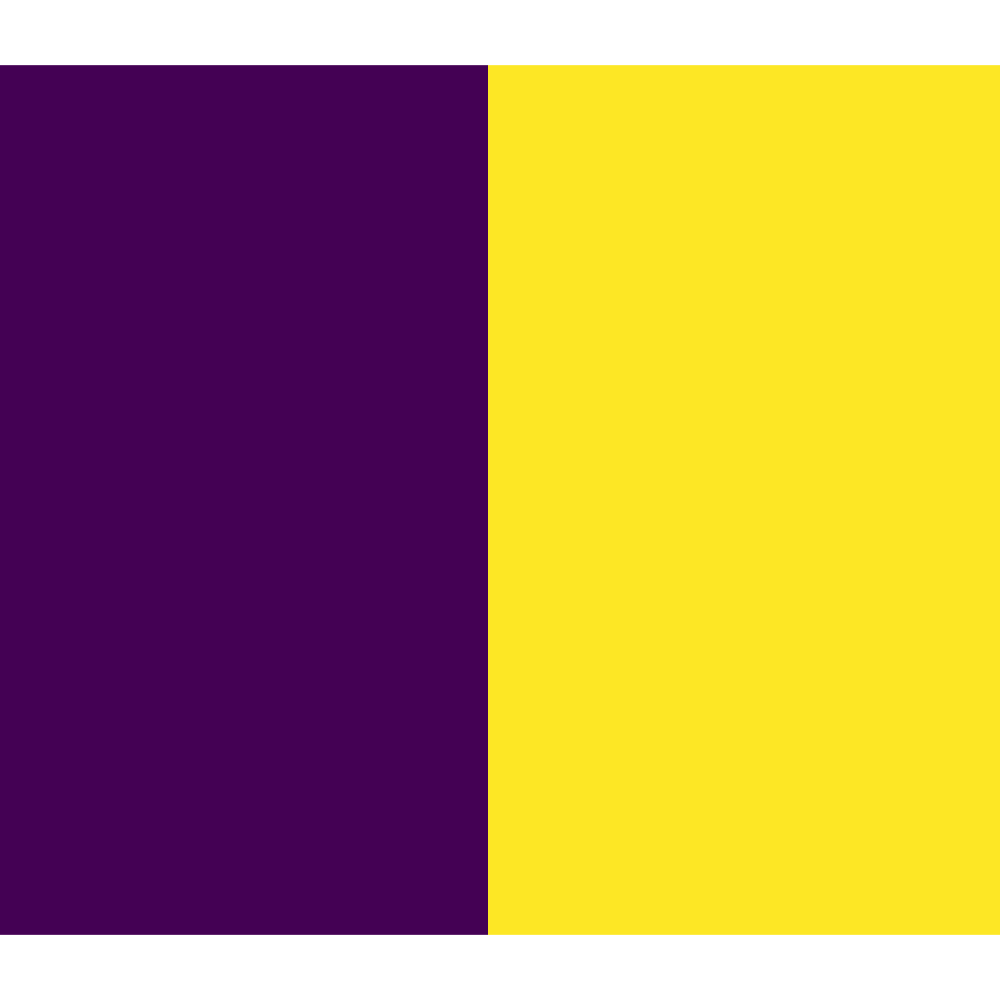

A working test:
# get extents
g.region -ec raster=L5192028_02820090723_Rad_ref_TRC_BYTE_FROMGLCaggV1@PERMANENT res=1000
north-south extent: 214230.000000
east-west extent: 246330.000000
center easting: 741150.000000
center northing: 5100000.000000
# set east to center easting of landcover map
g.region -a e=738150.000000 res=1000
# build a "half" map
r.mapcalc "WestHalf = 1" --o
# set west to center easting of land cover map, reset east
g.region w=738150.000000 e=$(echo "246330/2 + 741150" |bc) res=1000 -a
# build other half
r.mapcalc "EastHalf = 2" --o
# combine
r.buildvrt input=WestHalf,EastHalf out=fIRSTgRASSYvRT --o title="First GRASS GIS Virtual Raster Map"
r.info -ge fIRSTgRASSYvRT
north=5208000
south=4992000
east=865000
west=617000
nsres=1000
ewres=1000
rows=216
cols=248
cells=53568
datatype=CELL
ncats=0
map=fIRSTgRASSYvRT
mapset=lst
location=lst_time_series
database=/geo37/grassdb
date="Mon Jun 4 16:02:58 2018"
creator="nik"
timestamp="none"
units="none"
vdatum="none"
source1=""
source2=""
description="generated by r.buildvrt"
comments="r.buildvrt --overwrite input="WestHalf,EastHalf" output="fIRSTgRASSY\vRT" title="First GRASS GIS Virtual Raster Map""
# see in-terminal
g.region -a raster=L5192028_02820090723_Rad_ref_TRC_BYTE_FROMGLCaggV1@PERMANENT res=1000
ty.d.rast fIRSTgRASSYvRT # terminology's `tycat`
Thank you so very much Markus, Nikos
