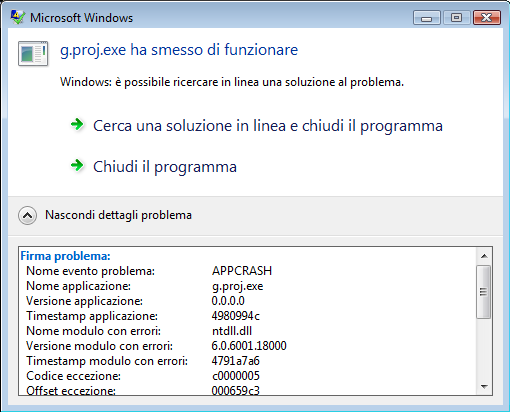

I know that the Windows Vista grass users community is not so wide, anyway I would like to know if someone is thinking about the problem I posted sometime ago and if someone else can reproduce it.
Whenever I try to create a new Location (in my case from epsg code) g.proj.exe crashes and returns the following message:
“child killed: segmentation violation”
and Grass returns, obviously, to it’s startup situation, waiting for the location/mapset selection to open…
I don’t know Windows system so well to debug it by myself. It would enough, for now, to know if someone else have faced it.
Giovanni
PS: I attach the picture with the Windows crash message
(attachments)
