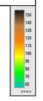

It is interesting the posibility of gradient legend in CELL map; it is easy to
program, I try it. The actual legend with gradient look as
ps_map_legend_float.jpg.

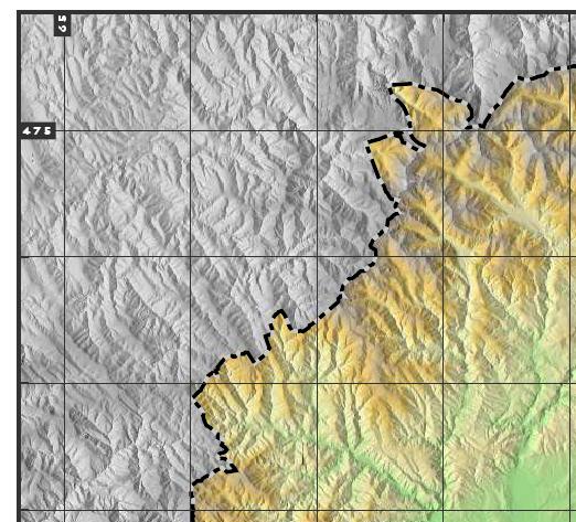

But the better improve (just run without problems) is merge two raster maps as
shown in ps3_map_raster.jpg (this was the mother of all changes :). Of course
without any cost in size of ps file, this work directly on the original
raster image, thus no more bytes of size to the file (option of second map is
color o gradient of one color -gray, blue, ....).

Those layouts are gorgeous. Once the SVN integration is done, would you
be willing to put some tutorial on the GRASS Wiki to show users how to
generate such maps with ps3.map?
