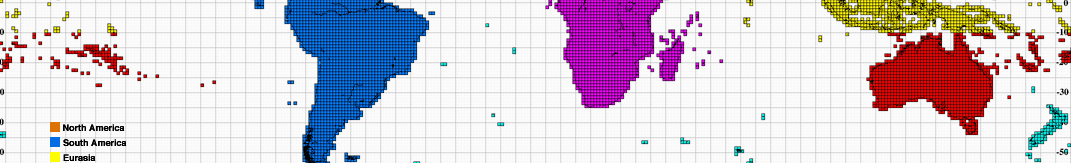

It is SRTM3 data grouped by continents loaded from frome0srp01u.ecs.nasa.gov. The continents have different number of rows but the same number of columns and (EW resolution) of 360+ degrees, so i think they contain a whole slice from east to west, like below. Most of it is nodata, so changing the ewresolution is no problem.
