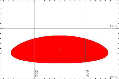

I am wondering, does r.grow.distance do the right thing in Lat/Lon?
If not, then the C version of r.buffer still has an important advantage
and should stay.
e.g.: (latest SVN for r.in.poly; see attached)
g.region n=60S s=85S w=30 e=60 res=0:05
r.in.poly in=- out=dot_map << EOF
P
45E 72:30S
= 1 dot
EOF
g.region n=43:20S s=90S w=10 e=80E
r.buffer in=dot_map out=dot_map.500nm dist=500 units=nautmiles
d.mon x0
d.rast dot_map.500nm
d.grid 30
Hamish

Hamish wrote:
re. r34409: Replace r.buffer with a script using r.grow.distance
No.
I'll look into adding metric=geodesic, but I'm not entirely certain
that it's compatible with the algorithm.
and should stay.
For now, I'll re-enable it, renamed to r.buffer2. It shouldn't be the
default, as it reads the entire map into memory.
Glynn Clements <glynn@gclements.plus.com>

Done, and modified the r.buffer script to use it. The results appear
to be identical to the C version.
